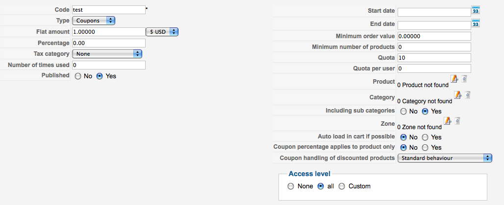

  • Posts: 20
11 years 10 months ago #85432
Here is the configuration shot of the coupon "test". For testing purposes, I set it for 10 total uses.
  • Posts: 2334
  • Thank you received: 403
11 years 10 months ago #85585
Hi there,
So what's the problem? Have you used this coupon 10 times?
If not it's normal that you can still use it.
