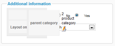

I tried looking for a solution online but could not find one, Please see print screen of my issue:
I get this on nearly all headings.... Anyway to fix it?

Actually sorry, my mistake I am using VTEM admin template and that is causing the issue, Do you help sort this out?
11 years 10 months ago #85653
Are the other components working fine with this template ?
Your template is overriding our views and broke the headings.

If the template is overing our view the only solution you have is to find the broken css in your backend.
Try to take a look at the css with a right click and your browser's inspect element function.
You must find some css rules which are override, adding some new css in your backend css file will then do the job.
If you have found these broken rules, you can also edit them like this (example):
float:left;
to this
float:left !important:
It will give the priority to our css code.
