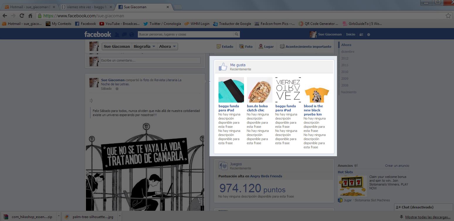

I dont know if this is a bug, but is happening in all the hikashop sites. When i make click to the facebook button like, and when i see how it looks in facebook, the name of the product is correct, but the image isnt (it takes what ever random image of the site), and the description of the product doesnt show: "No hay descripcion para este producto" that means, "there is not description of this product" and it repeats 3 or 4 times.
First, i thought that it was a facebook problem, so, i followed the facebook developer instructions and i solved the part of the image. But i have been working on fix the description issue for days, and i cant find the solution.
This is weird, because i remember that the like button worked perfectly at the beggining, in all my sites, and suddenly, one day, everything was wrong. I kind a think that this has something to do with the new hikashop version, but i am not sure, because is not clear to me if this problem is from before, or after my last update.
Anyway, i really hope someone can help me. I have days working on solve this, and i just cant.
