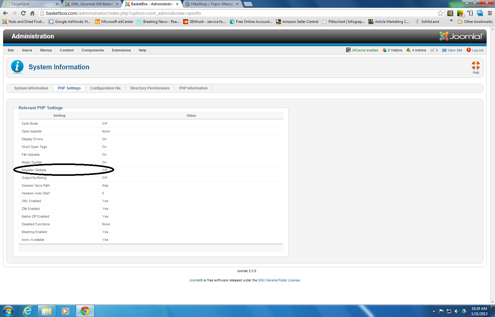

  • Posts: 69
11 years 10 months ago #86425
Our register global is off. See screenshot. Any other solution?

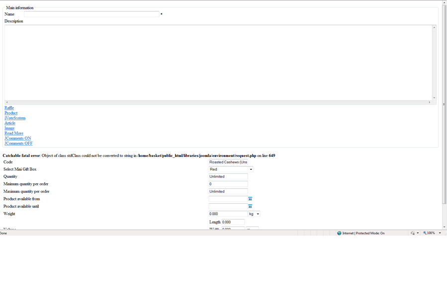

Have not tried debug yet, but attached is a screenshot of what I get when I:
Go to a product
Click manage variants
Select variant
Remove code field old data and add new data
Select save and close
Then I get the error attached.
