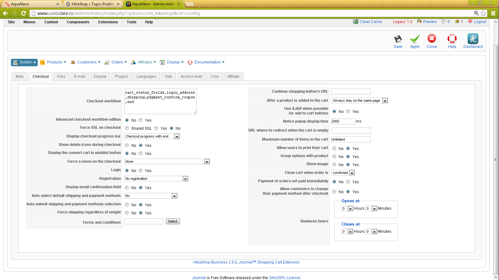

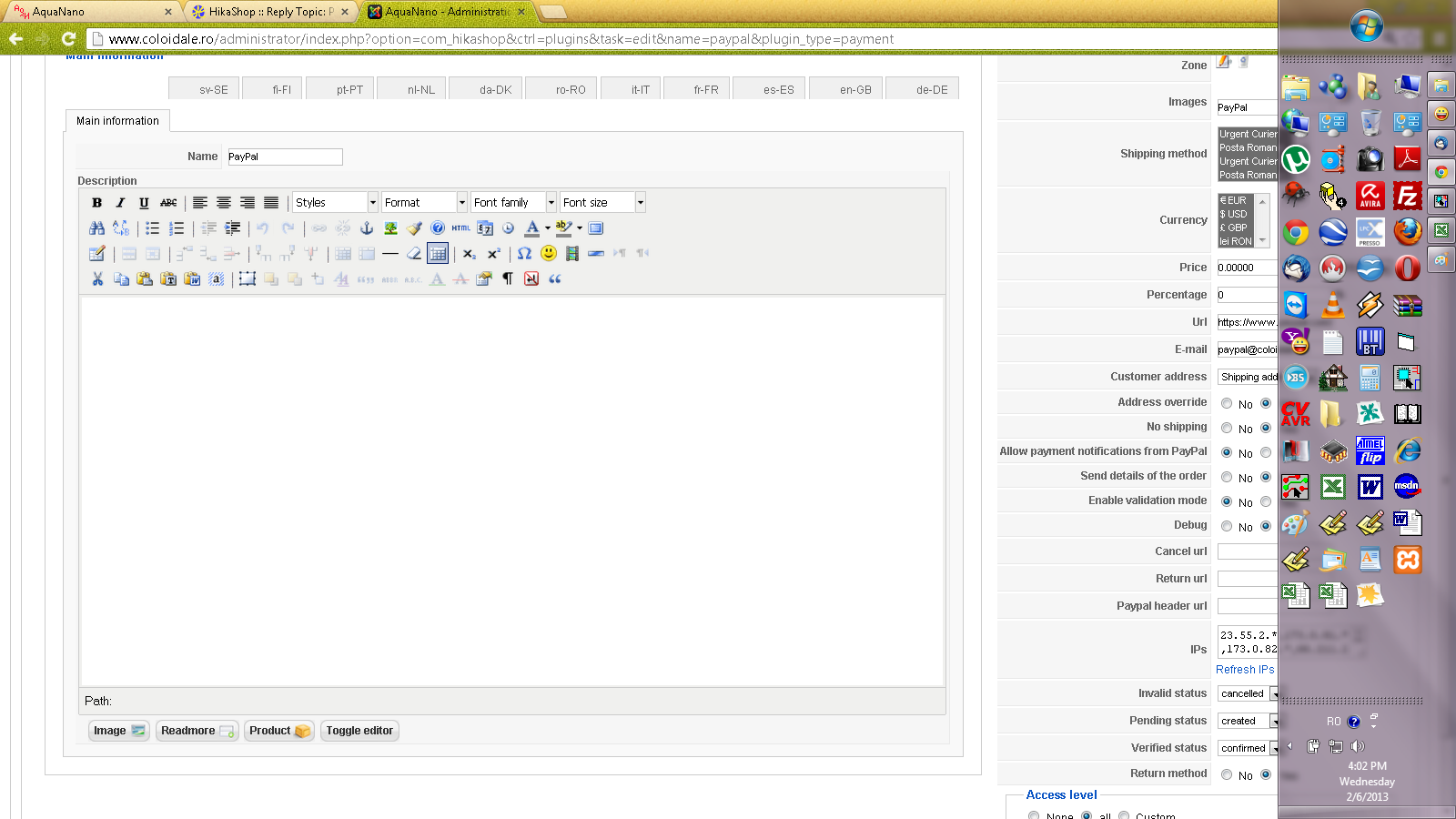

Can you give use screenshots of your checkout configuration and of one of the both payment methods ?
You can try to install the latest version of HikaShop from our website.
  • Posts: 76
11 years 9 months ago #88804
You have the images with the checkout and paypal method. I don't think it is from settings, but who knows.
