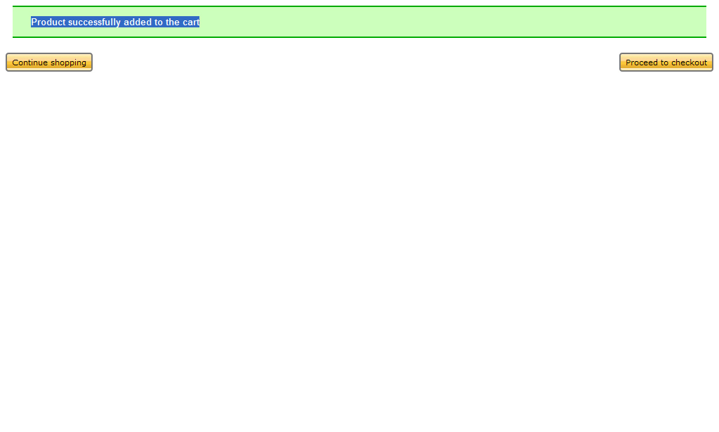

After updating to Hika 2.01 Im having 2 issues with the "Product successfully added to the cart" pop up window.
1 - After just a couple of seconds the frame brakes and the pop up expand to take up the whole page (see image)
2 - The "continue shopping" button wont work. I went to the setup and added a costume URL but still didnt work.
I searched your forum for a solution before posting but could not find any posting that would help me with this issue.

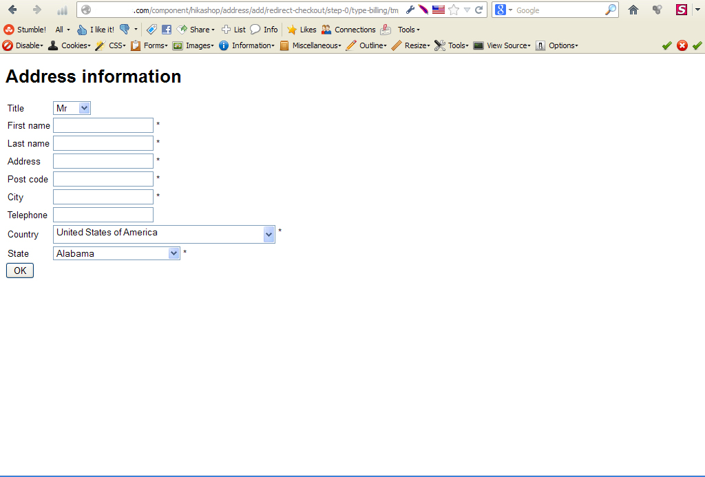

12 years 2 months ago #90478
I continue to have the same problem. Popups generated by hikashop brake the frame and take over the whole window. (see attached image). The problem in the enclosed image occurs when I click on the "New" button for costumers to add a new address in the check out process.
I really need help with this issue because it will drive costumers away once I open the shop.
This is actually on a different server and a different domain (I changed the domain attached to my subscription)
