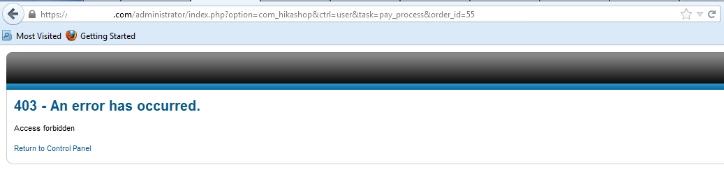

I have the following error in the "HikaShop Business"
When I pay the fees to partners'm getting the "access forbidden"
What can it be?
  • Posts: 26171
  • Thank you received: 4030
11 years 11 months ago #89704
Please update the file "administrator/com_hikashop/controllers/user.php" and add the indicated line:
		$this->modify_views[]='pay';
		$this->modify[]='pay_confirm';
		$this->modify[]='pay_process'; // Add this line
It would solve your forbidden access and it would be include in the next release.
  • Posts: 8
11 years 11 months ago #89710
not solved the problem ...
  • Posts: 26171
11 years 11 months ago #89714
Right !
It's better with "modify_views" like
$this->modify_views[]='pay_process';
  • Posts: 8
11 years 11 months ago #89728
This problem was solved.
