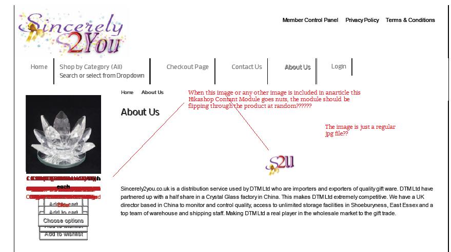

Hi anyone know how to stop the HikaShop content Module from laying multiple products one on top of the other when the module is set to have a single column and more than one product. I have the random image set to 'yes' and the carousel set to 'yes' with a transition os 3200.
If an article has an image in the article it causes this problem. It took me some time to make the connection but when I removed the image from the article the HikaShop Content Module worked fine??

You have maybe a javascript error/conflict. Could you give us a link to your website ? We are not able to reproduce this problem on our end.

an error is present on the page with images:
ReferenceError: jQuery is not defined
[Stopper sur une erreur]
jQuery(document).ready(function($){
Try to install the plugin jQuery easy and see if it solve the problem.
