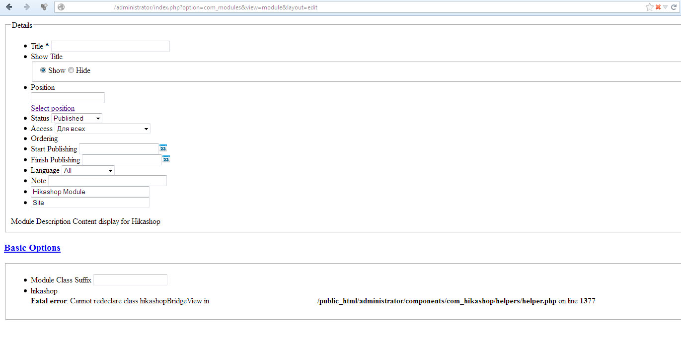

Module Custom HTML does not work after installing hikashop-starter-2.1.0 on new joomla 2.5.9. In place of the module Custom-HTML there is a white screen.
Error logs:
2013-02-24T17:39:22+00:00	INFO	controller	Checking edit ID com_modules.edit.module.106: 1 Array (     [0] => 107     [1] => 109     [2] => 106 )
Also do not work modules "HikaShop Content Module", "HikaShop Filter Module", "HikaShop Currency Switcher Module", "HikaShop Cart Module". When they are created (Extensions - Module manager - New) there is a window error.
Hikashop_starter_1.5.7 working fine.
What to do?

11 years 8 months ago #91759
Please change the line:
if(!include_once(rtrim(JPATH_ADMINISTRATOR,DS).DS.'components'.DS.'com_hikashop'.DS.'helpers'.DS.'helper.php')){
to:
if(!function_exists('hikashop_config') && !include_once(rtrim(JPATH_ADMINISTRATOR,DS).DS.'components'.DS.'com_hikashop'.DS.'helpers'.DS.'helper.php')){
in the file components/com_hikashop/fields/hikashopmodule.php and try again.
The following user(s) said Thank You: Nurt
  • Posts: 12
11 years 8 months ago #91803
I replaced the line. Did not help.
  • Posts: 82863
  • Thank you received: 13372
11 years 8 months ago #92041
We don't have the problem on our end so we cannot debug it.
Please provide a backend and FTP access to your website via our contact form and we can look at it
  • Posts: 12
11 years 8 months ago #92060
Thanks, but the problem is solved. I'm installed version of php 5.4 instead of 5.2, and it worked.
