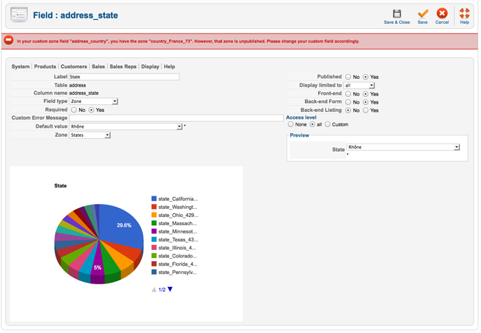

It's not a bug. It's probably because of the way you configured your states/countries/custom fields with 1.6.
On each update/install HikaShop adds back all the states/countries and the links between them. So if you had deleted some of them, or deleted links between some of them, you could experience such strange behavior. But normally, you don't need and shouldn't delete them. You could simply unpublish the zones you don't need and make sure that the default value of each custom field is properly saved via the menu Display->Custom fields. I suppose that the default value for the countries and states fields is not correct at the moment on your website so it displays wrong data. Edit them, make sure that they have the correct data and save them and that should already help

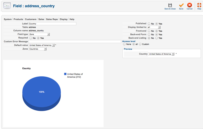

Now that I have it restored to 1.5.6, in the custom field section, I am getting a strange warning. Any help of where I have gone wrong would be appreciated!
