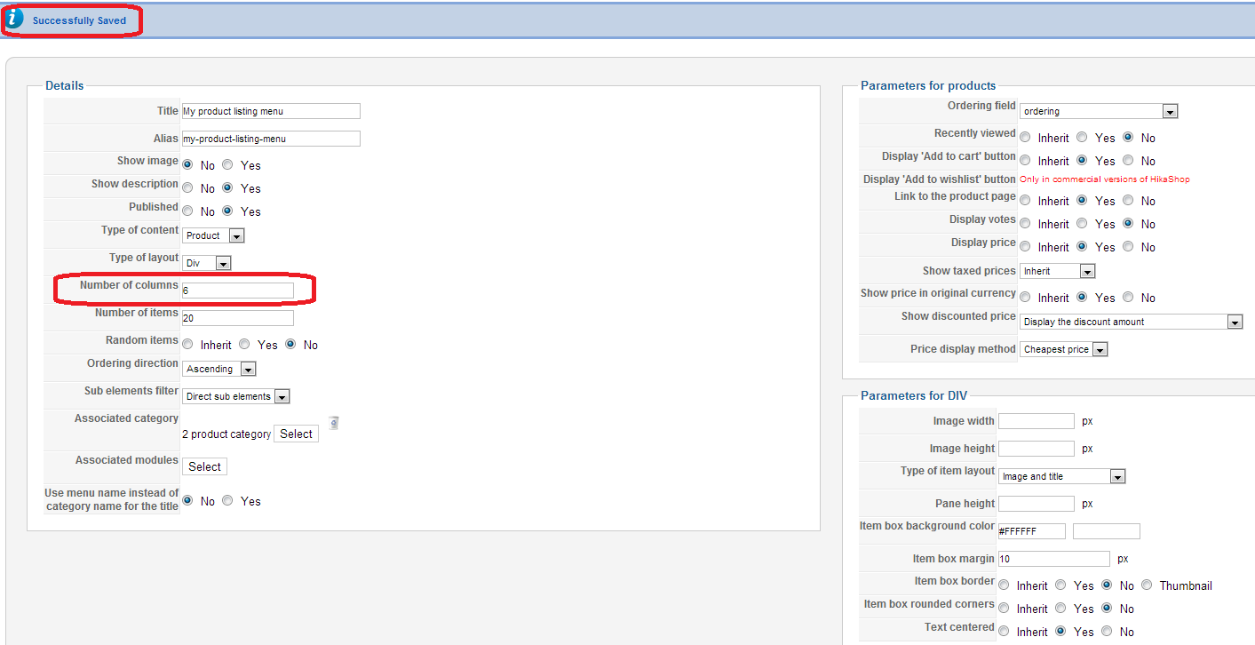

I can't link my product listings to a menu. I've followed the directions provided in the documentation: I create a new menu item in Joomla, then save it. Then I click on the Hikashop options to to configure it. But when I go to save the Hikashop options, it's like the settings won't save - the number of columns & items is blank, the assoicated category is reset to the default category,and none of the oher parameters are saved either. When I click on the menu item from the front end, no products are displayed, nothing shows up, except for the Hikashop footer link.
I am running Joomla 2.5.9 and Hikashop 2.1.0. Please help, thanks!

I went to the menu item you created, and it looked like the number of columns and items saved for you, but when I tried to save the associated category as "Shoes" it still wouldn't save. It just reverts back to the default "product category". I need to create a menu item to point to each category. I even tried creating a category to link to in the "Root", but it still wouldn't work.
Are you able to get it to point to a specific category?

I checked that for you and I was able to change the associated category too.
Are you sure you're clicking on "save" ?
Also, try with another browser. It's maybe a cookies/cache user session issue which could explain why you're the only one with the problem. If it works with another browser, you should clear the cookies/cache of your usual browser and try again and it should work too.

Thank you, that worked!
I switched to a different browser- I was using Chrome and I switched to IE - and it worked. Then I cleared the cache of Chrome and it worked there as well. I would have never thought that was problem, thanks again
