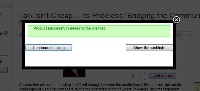

I upgraded from 2.0.0 to 2.1.1 and everything seemed to go fine, but now, on random occasions, instead of giving the option to "Proceed to checkout" to the user, it instead says "show the wishlists". When the user clicks on that button, it sends them to an error page: www.multifamilyinsiders.com/shop-multifa...showcarts/cart_type-
This behavior seems to be random, and I have wishlists turned off in the following location:
  • Display > Display 'Add to wishlist' button
However, the option "Checkout > Display the convert cart in wishlist button" is neither No or Yes - I am unable to change that setting.
Any help? Right now, the cart is unusable half the time.

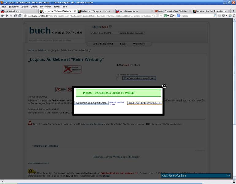

11 years 7 months ago #96473
I assume I have the same problem as follows:

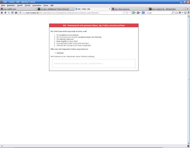

When customers try to add the first article to their cart, they receive this Popup Notice (Screenshot 1).
Clicking on "Display the Wishlists" results in Error 500 (Screenshot 2), clicking on "Continue" instead usually works fine.

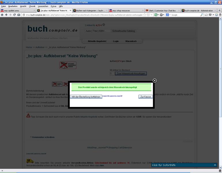

In contrary to what brentwilliams2 experienced it is not random with me; from the second article added on it works fine (Screenshot 3).
I (currently) do not need wishlists at all (I hopefully have turned them off correctly in the settings), but I desperately need my cart function working properly :( .
