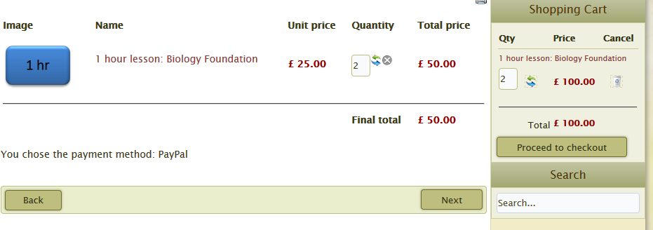

Just upgraded to latest Hikashop 2.1.2.
An anonymous user, on adding an item to the shopping cart sees the mini cart module in the sidebar showing no items. As soon as a user logs-in those items are there and waiting for that user to proceed to checkout. It used to be the case that anonymous users could add to cart and this would be reflected in the mini-cart contents.
This change in behaviour occurred after upgrading to 2.1.2 today. I have checked all the settings and can see nothing unexpected. Anonymous users, on visiting the shop, need to see their cart contents so that they can proceed to checkout. The way I have configured the system is that the mini cart is the ONLY way to proceed to checkout.
What could be the problem?
Thanks,
Ric
Added after further tests:
It looks as though the problem was nothing to do with the upgrade to 2.1.2. The problem is that to improve performance I had turned caching on. Joomla does not appear to handle caching selectively: it's all or nothing.
However there is now a problem that may be due to the 2.1.2 upgrade. When items are added or deleted from the cart, the mini-module displays the items. If the item quantity is changed in the mini cart (and the update button clicked) the total price is calculated incorrectly.
If the option proceed to checkout is taken then quantities can also be changed during the latter stages of checkout. Changing quantities there does calculate amounts correctly. However the correct amount is not displayed correctly in the mini-cart.
All caching is off, system cache plugin didabled, browser cache cleared. Problem persists

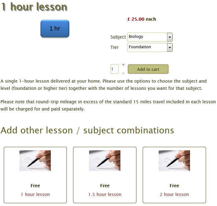

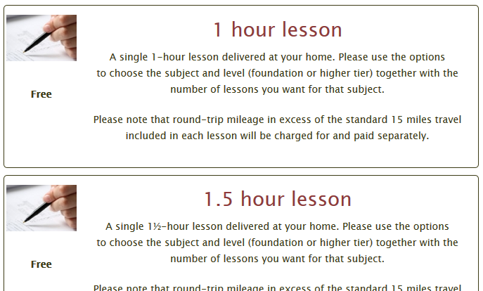

The related products are still displayed as free:
Ric

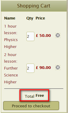

I spoke too soon. Unfortunately the mini-cart total does not display correctly (the individual items do and the recalculation of price is correct when quantities are changed):
I think it's a display problem because the correct prices are transfered to payPal during the payment cycle.
Thanks,
Ric
