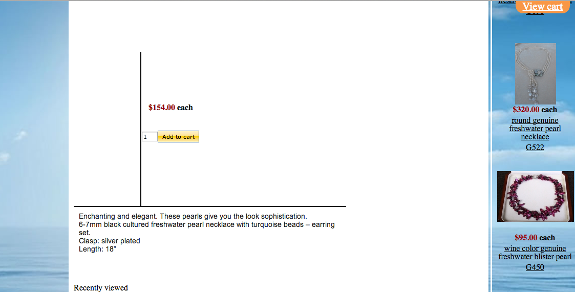

I do have ssl for my domain.
when I access to product page without ssl everything works just fine, but when I go to the same page in ssl mode everything is messed up. Does anyone know why?
Here is an example:

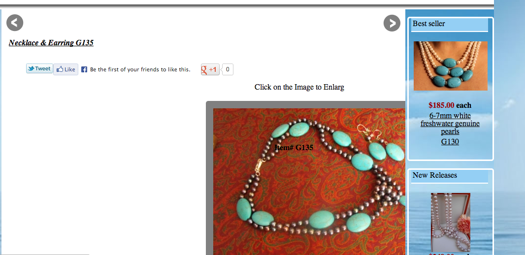

11 years 11 months ago #101123
The display seems to be ok with the SSL module turned ON, can you show me how your product page is showing without SSL ?

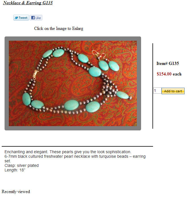

11 years 11 months ago #101180
I wish the page look like the picture in ssl mode, but it does not. This is the picture I get in ssl mode.
how do you get that picture in ssl mode because I even changed my browser and get that weird looking layout??

11 years 11 months ago #101194
Change the code:
#hikashop_social iframe.hikashop_social_fb_standard {
width: 300px;
height: 80px;
to:
width: 300px;
height: 30px;
in the frontend CSS file of HikaShop via the display tab of the configuration and that will solve the issue which comes from the facebook iframe in https.
