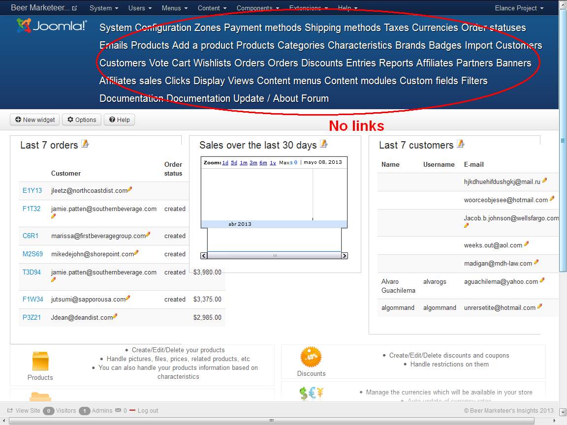

I'm using HS 2.1.2 in Joomla 3.1.1 and when trying to access Hikashop control panel in backend, its menu breaks totally and only displays menu text in h2 format but no links at all. I'm using default 'Isis' admin template

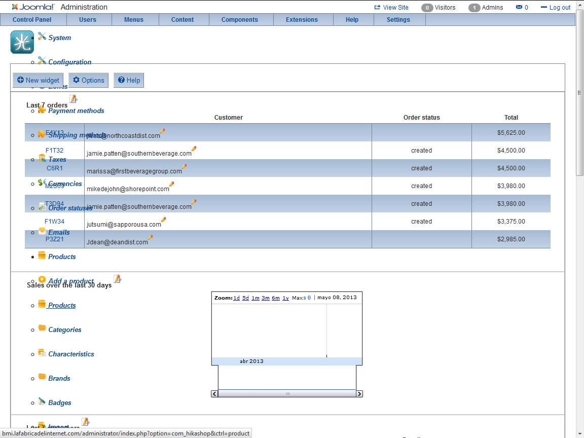

I switched templates to 'Hathor' and it works a bit better but still buggy: all menus/submenus display, but without any format. It displays a large unordered, nested list, without any format that overlaps all other content in page.
I managed to style Hathor to fix the menus but the result is weird and other extensions do terrible when using Hathor, in the other hand the only one that displays wrong with Isis is HS, if at least links worked correctly, it would be faster to fix css for Hikashop only.

I attach screenshots of both templates implemented for HS.

That's because the Isis template is not compatible with the way you set the "menu position" option of the HikaShop configuration.
By default is it set to "above the content" on Joomla 3 so that you don't get that issue. Please switch back that option to "above the content" and that will display fine.
