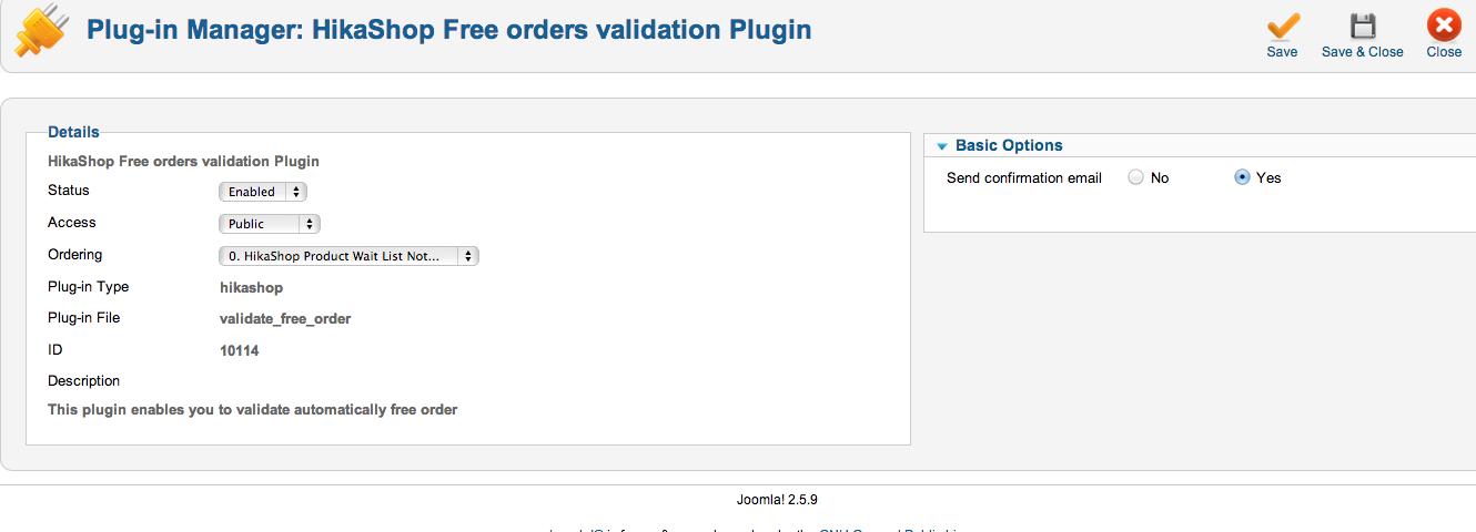

In which mode is the "validate free orders" plugin : With notification or not ?
  • Posts: 241
  • Thank you received: 5
11 years 11 months ago #103533
If notification means email confirm.. it is on as per screenshot.
