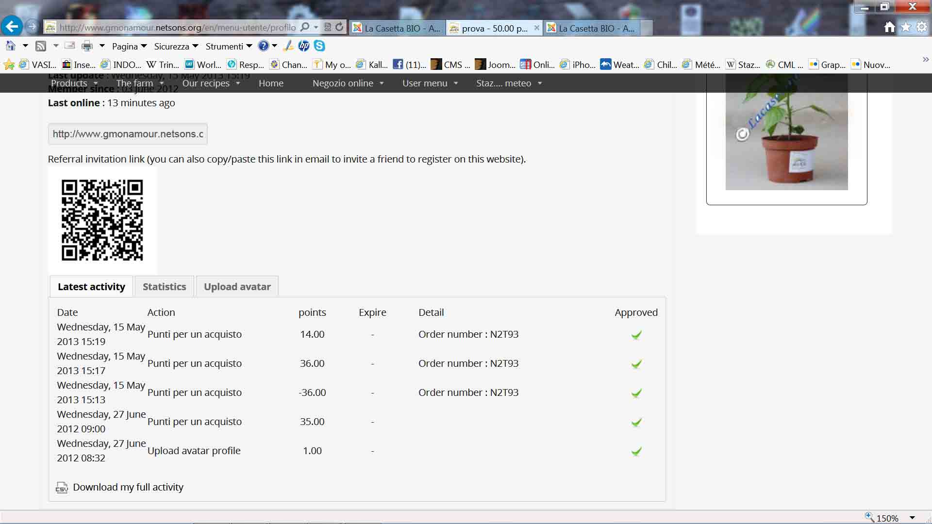

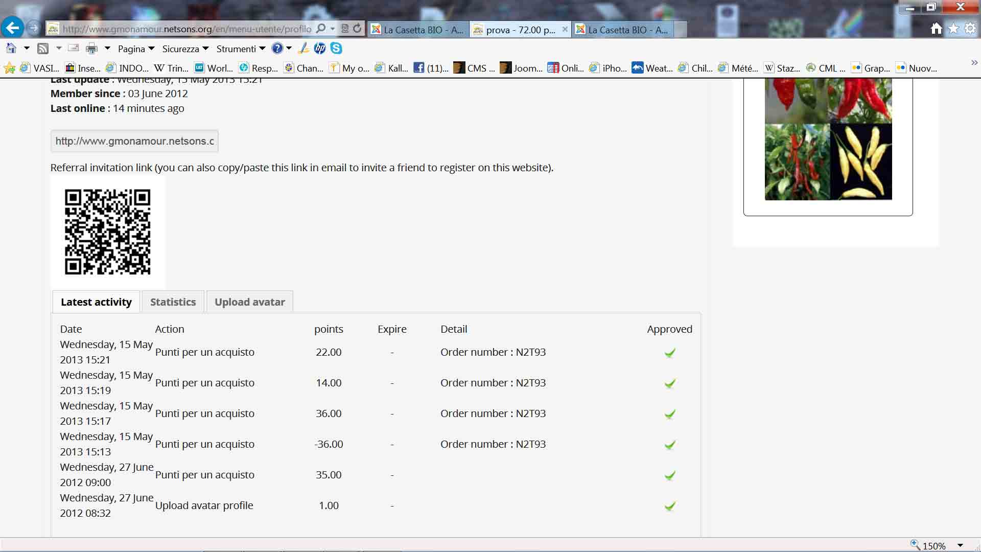

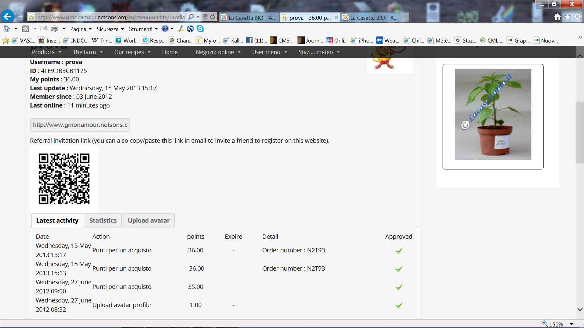

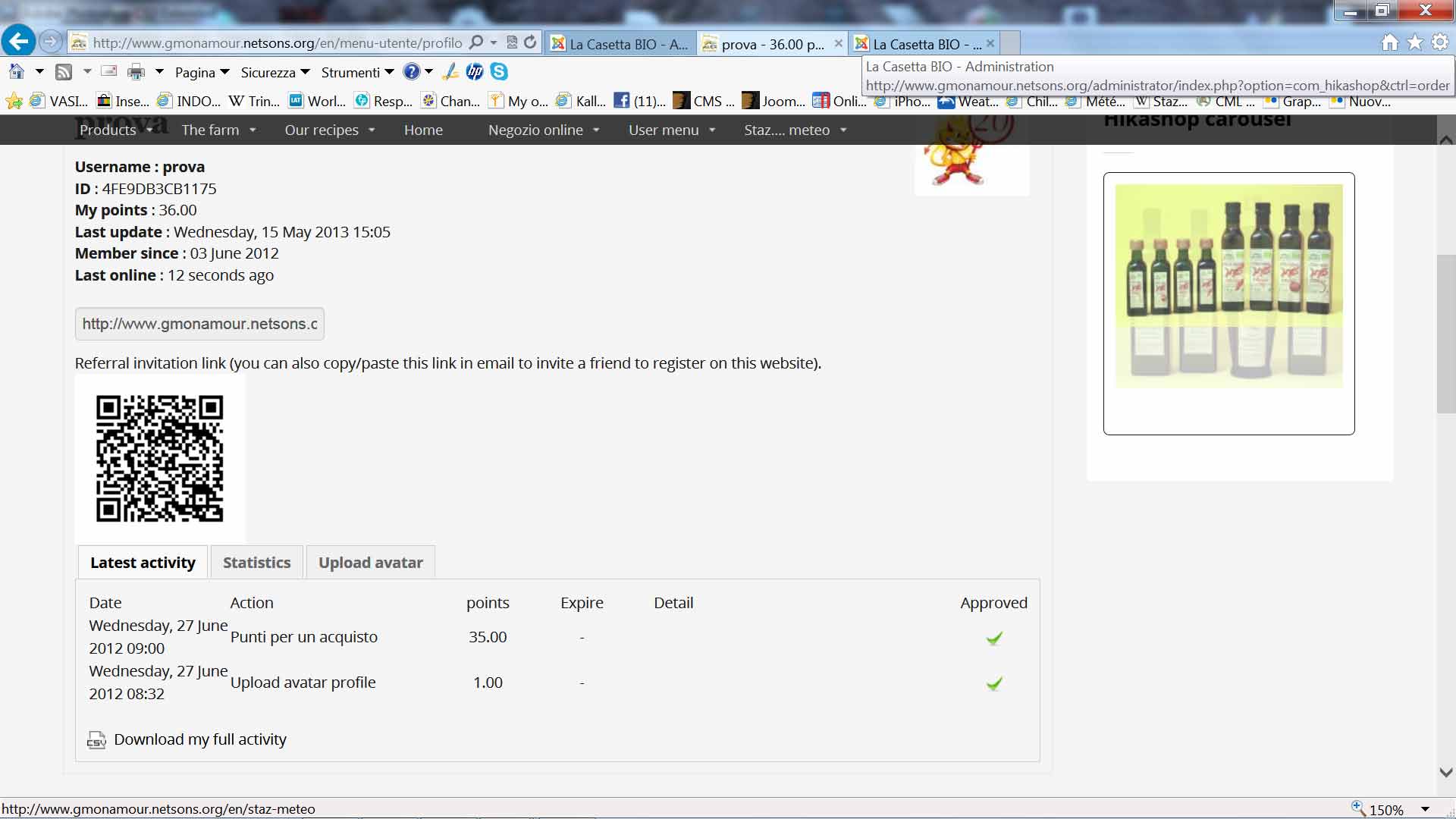

I notice a bad behavior of you payment points plugin.

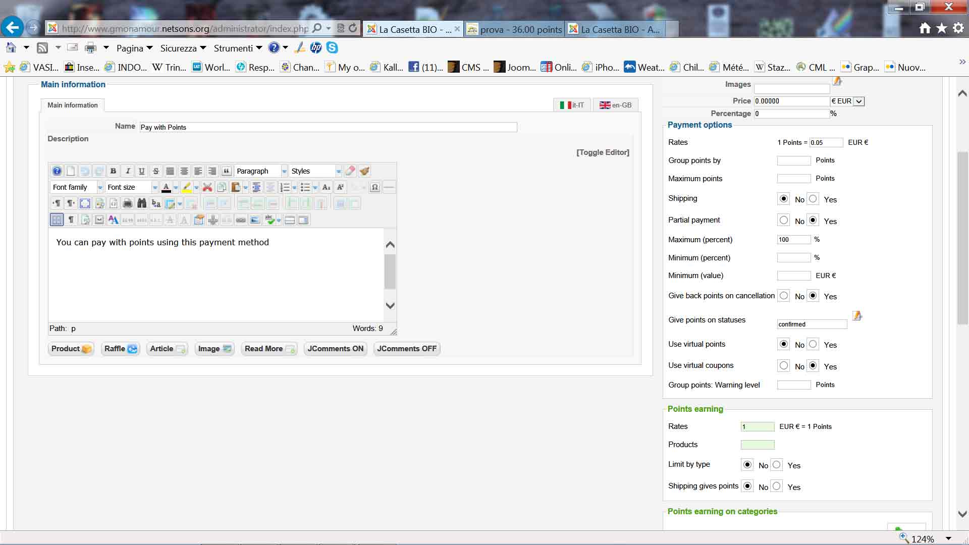

So, first i have this first points situation
I have this setting on your plugin
I do a purchase of Euro 15,40 plus Euro 8 of shipping cost: the total is 23,40 - euro 1,80 for 36points = Euro 21,60
I set the order to payed and i have this situation
Then i set the order to confirmed and i have this
Finally i set the order to shipped and the final situation is
The sistem gives me an amount of 72 points
But i must have only 15 points that are the points of my last purchase.
What's wrong?

You have a wrong configuration in the plugin.
In the option "Give points on statuses" you should list all "valid" statuses. So "shipped" should be in the list too.
Can you provide some text values instead of big screenshots, it is a little bit complicated to analyse the history of order/points.
