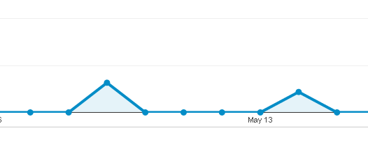

This is what we have in analytics:

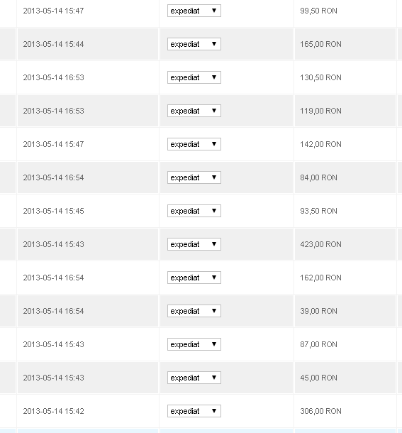

And this is for the the sales on 14.05.2013.
As you can see there are around 13 transactions on 14.05, however in the analytics there is only one. Unfortunately, the Hikashop report for sales doesn't work either, shows way to much for the income. So right now we don't have a simple solution for monitoring our sales statistics.

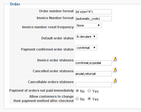

You probably didn't set the option "Payment confirmed order status" option of the configuration with the status you're using for the orders when you ship them.

It seems that is not the problem. We have this in configuration:
The status of a new transaction by default is 'in derulare'. After this we always confirm our new transactions with 'confirmat', and when the goods are sent from our company we set to 'expediat', which means shipped. This sequence is an internal policy and it is always respected (to be sure I just checked this with our sales department).

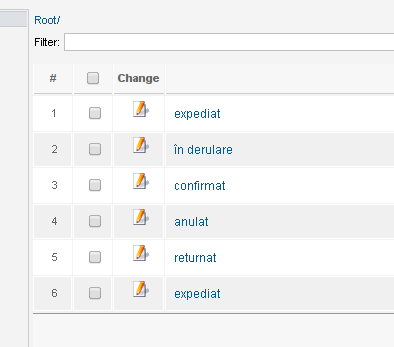

I couldn't find in the language file, nor in the configuration, so I have changed directly in the mysql database, in the hikashop_config table. Unfortunately I didn't check if the analytics plugin takes the status from the database or the string is hard-coded. Maybe you know the answer and some possible fix for this?

I think that the problem is due to the change made in database. The plugin, and all the other things are based on the name in the database, so changing it here can broke many things.
Thanks to revert back the default values, and if you have Falang or Joomfish installed, you can go in HikaShop > System > Order status and change the statuses here by clicking on the flags.

Furthermore, I just find out that the statuses can be edited in the administration backend (you have to check and click edit, a simple click on it won't do it), so there is no need to edit the table in the database. So at this point it seems to me that the problem is laying somewhere else.

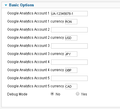

So if you have that option turned on in the plugin and the plugin published and the firebug console of firefox opened while you confirm the order status of an order in the backend, you will see the debug information printed in the console and potential errors. Here is an example of the debug data that you will get in firebug:
www.hikashop.com/media/kunena/attachment...ytics_back-end_2.jpg
That will allow us to understand what's going on.
