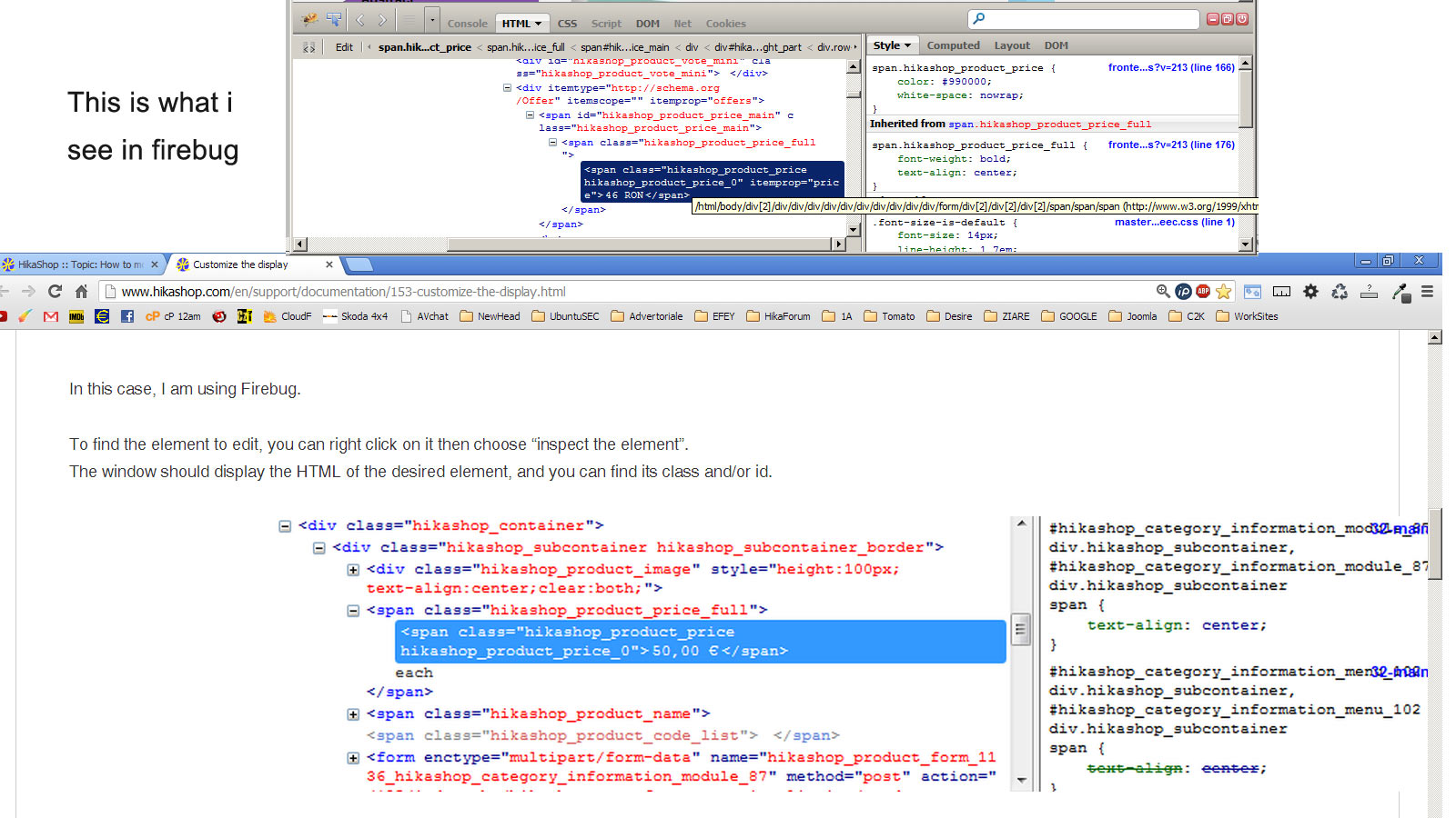

I went to this article: www.hikashop.com/en/support/documentatio...ize-the-display.html
And regarding the CSS - i kind of found my answer regarding the price customisation - it's exactly the example in your document.
But there is a problem - i've attached you a picture of my firebug and comparison with your firebug printscreen from the link above. The problem is I can't see the mention of a Module and number.

Modifying the "default_frontend.css" file is not recommended and if you lost your modification, it is logical because it's not the way to do.
In HikaShop backend, you have a special interface which allow you to create custom css file. You so can customize the default css file and create your own.
Because this new file is not in the HikaShop package, it will not be replace during updates.
If you modify core files without using overrides, you will lose them.
That's why we create interfaces for override views, css, etc.
For you last question, could you provide a link to the page you're talking about ?
The module id is not where you had your cursor, it is above (a parent node).
But it could be a menu id, it depends on the page you're talking about.

I don't see the problem with the screenshot of the documentation. Of course you don't have the module with the id on the right of the screenshot since you're looking at the product page, not at a module HTML/CSS.
Since it's on the product page, you can use that:
.hikashop_product_page .hikashop_product_price{ color: #99cc00; font-size: 14px;}
