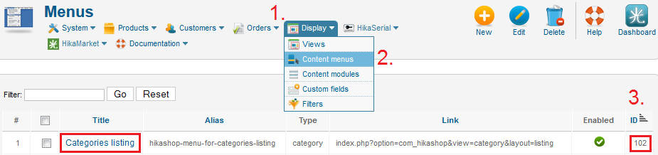

11 years 11 months ago #105274
You have to find the id of the categories listing module like on this screenshot:
Concerning the Facebook links, they seems to be good, the link is the same but with the facebook parameters added to the link.

Kaffeman wrote: Thank you but I've tried the one with ID 102 which is the same module as you have there, still no luck.
Xavier didn't told you to use the id 102, but to retrieve YOUR id like explain in the screenshot.
The screenshot of Xavier come from his local website so his id are not the same than yours.
Otherwise he gave you directly the right number :)

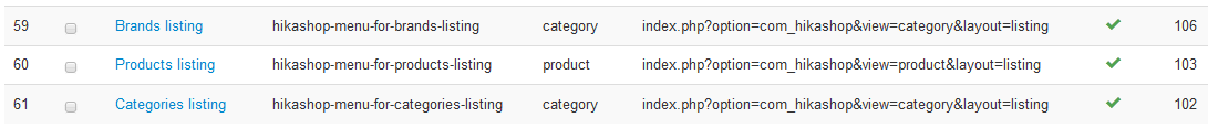

Xavier wrote: Hi,
Sigh
I really don't get it and I'm thinking that it's because of something that I have done since I have PROBABLY not done as you, the developers, had intended.
My categories listing that I was refering to after the screenshot from Xavier looks like this.
Apart from those categories in the Menu Module Listing I have like 58 more to choose from, don't really know which one to pick if the ID 102 isn't valid. Have tried to pick one category and then search for an item in that given category but the result is the same, first search works but the rest gets the added ?itemid=XXX.

So, it is rare but you have the same id than Xavier (and this is a coincidence, the menu is created by Joomla so we can't choose it).
The search plugin generates you some wrong links. The fact is that it adds is own menu id to the url (the "Itemid=120" or the "Itemid=138") so when the url is processed to be "nice" (what we call the SEF), the itemid is not the id of the "category listing" so the url can't be the same.
So, now we know that the ItemId required for generate a nice url in the "category listing" is "102", we can follow the instruction of Nicolas:
The solution is to configure the search plugin properly by enter a hikashop category listing menu item id in the menu item id option of the search plugin.
And configure the search plugin with the menu item id : 102.
