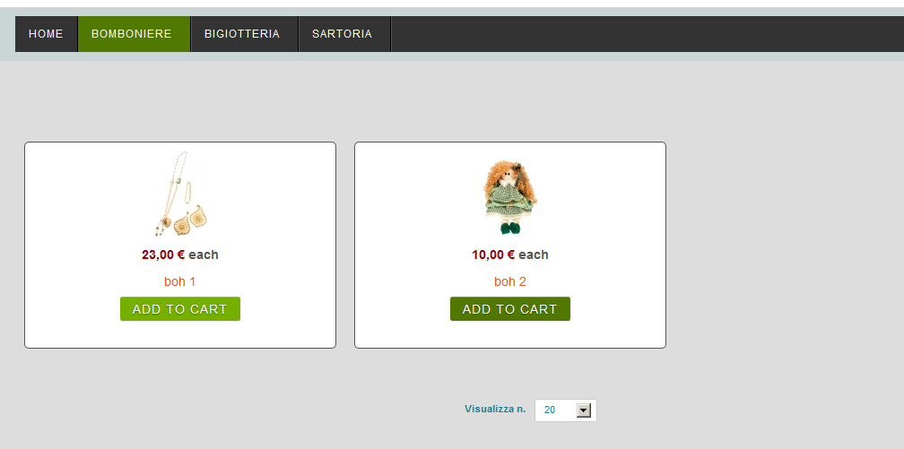

Hi to all, i have a strange problem with the "add to cart" button.
When i have the list of product, i click the button and nothing happend, but when i clic the single product and i clic the button all work well... how it's possible?
Ty to all

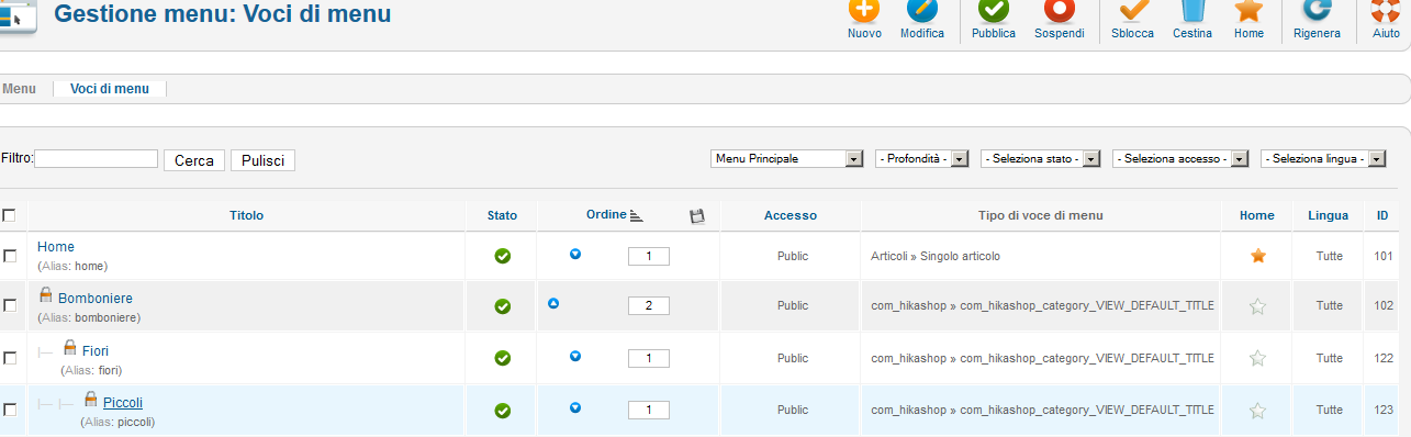

11 years 10 months ago #106682
Here some screenshoot. i notice a thing, when i create the menu voice "piccoli" and i chose "product view" type.. when i save, automatly change in category view..
I still don't undrerstand what i misunderstand

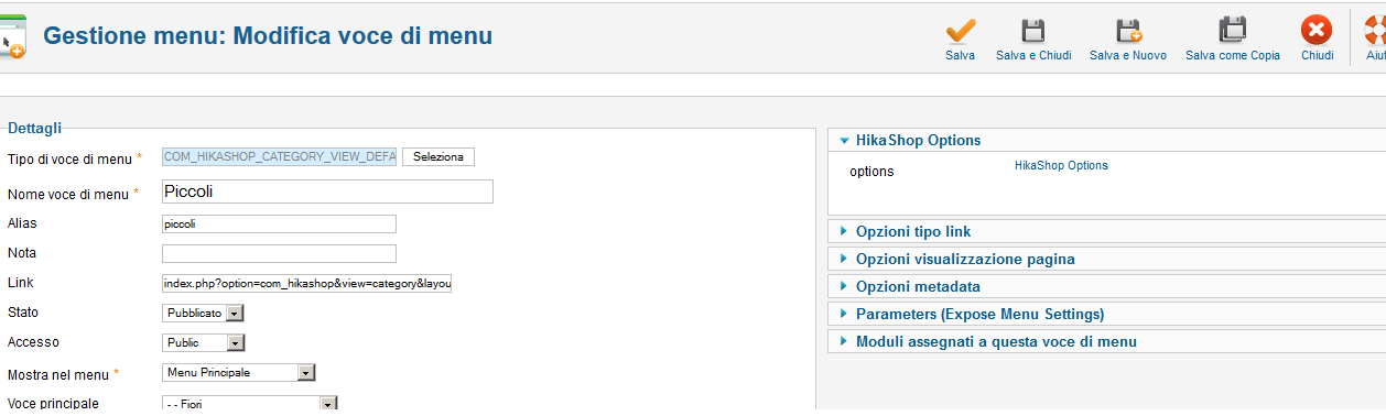

11 years 10 months ago #106746
Can you give us a screenshot of the hikashop options of the menu displaying a product listing ?
And if you use a category listing menu, give us the screenshot of the configuration of the associated module.
Thanks to enable the Joomla debug mode, set the error reporting to "maximum" to see if an error is returned when saving the parameters.

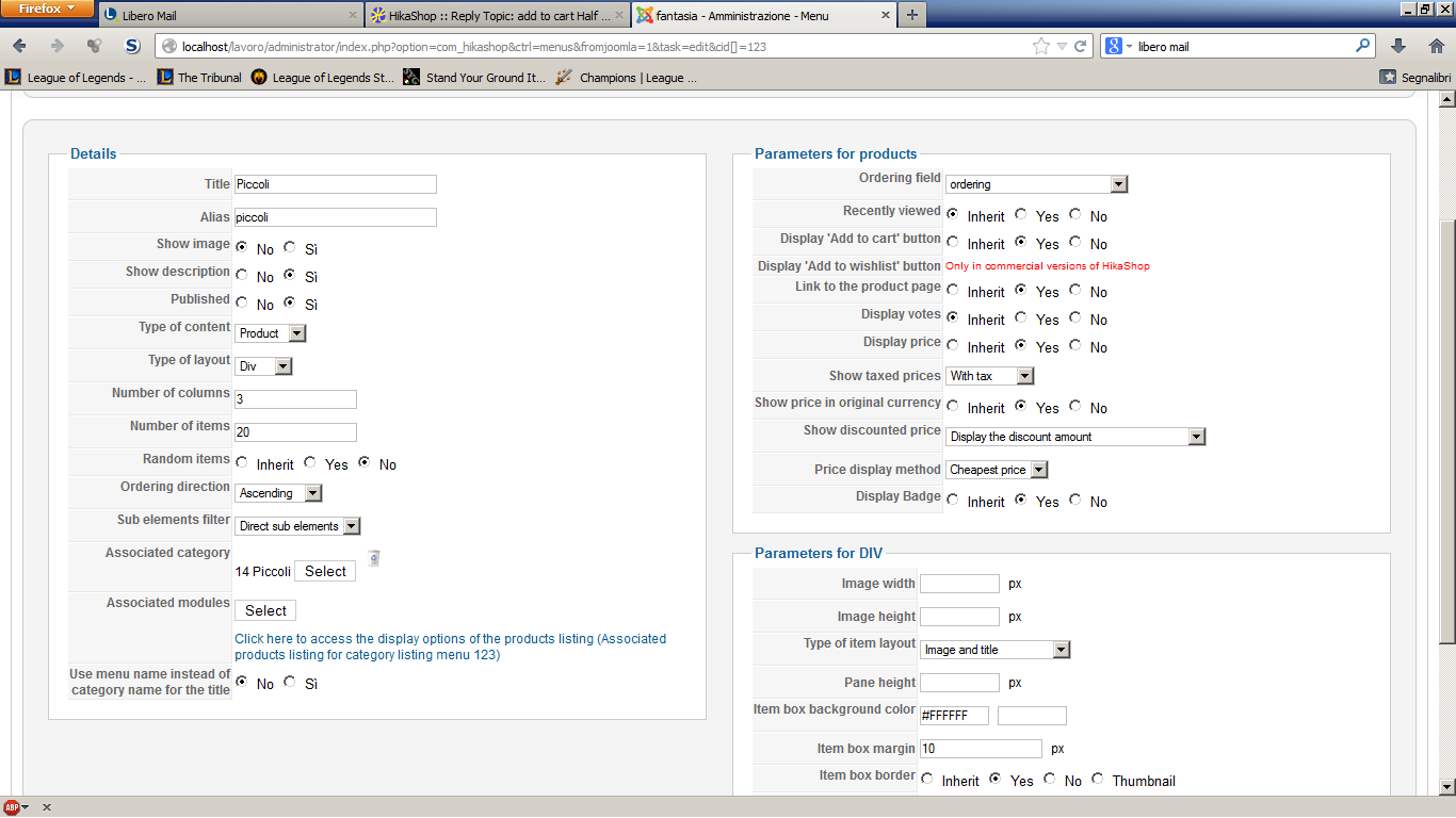

I mean, the Problem is this button in the list of product view. Can I hide the button in this view and let it appear Only when the clic on the specific product?
  • Posts: 83604
  • Thank you received: 13536
11 years 10 months ago #107228
Ah yes, that's easy.
Just turn off the "display add to cart button" option of your products listing menu:
www.hikashop.com/media/kunena/attachments/20474/Immagiane.png

  • Posts: 30
11 years 10 months ago #107323
I have already turned off the option "show the add to cart button" in piccoli, but really, nothig happend
11 years 10 months ago #107379
If this option doesn't wok it's probably because you have edited the view "product / listing_img_title" and the part with the option has been removed.
Thanks to save the content of this edited view in an external file, then remove the modifications by clicking on the dustbin in the views listing and try again.
