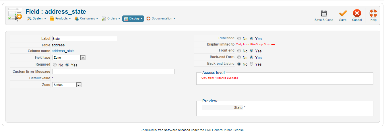

When i save FRANCE as the default country, the default STATE value is not accessible

Please edit the country custom field, select your default country and save the field.
You have to re-save the custom field in order to store the right default contry.

I just wanted to report that all is well now...the problem, as I suspected in my original post, is that I am an idiot.
:laugh:
I had actually gone through and UNPUBLISHED all of the Non US countries and states to make navigating through the menu easier, but in a fit of clicking had even unpublished EVERY state, resulting in no states being published and therefore none being available for a dropdown.
If had been more awake and clear headed when i did that, I wouldn't have had to bother you folks. Sincere thanks for putting up with my stupidity.
