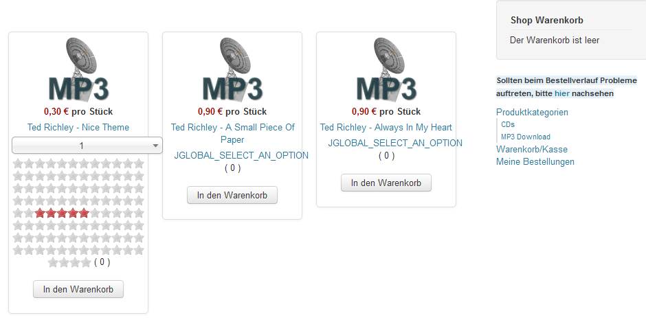

There's an issue with the display of voting (rating) at the procucts list page. The stars of all products listet are consolidated to the fist product in the list while any other products show "JGLOBAL_SELECT_AN_OPTION"

Can you give me a link to that page in order to see what is not working ?
You probably have duplicated ids, or a javascript error/conflict.
You can try to install jQuery easy to solve the conflict problem.

11 years 10 months ago #107448
The problem is because all your vote area have the same id. The product id is missing in this dynamically generated id.
Have you edited the view "vote / mini" ? Thanks to try to reset this view and try again.
