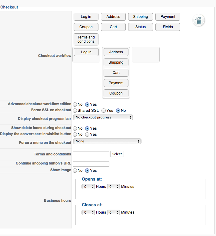

Can you give a screenshot of the checkout tab of the configuration and a link to a product page so that we can see that ?
  • Posts: 27
11 years 10 months ago #108580
Hi Nicholas, the config shot is attached. We PM'd you the rest.
