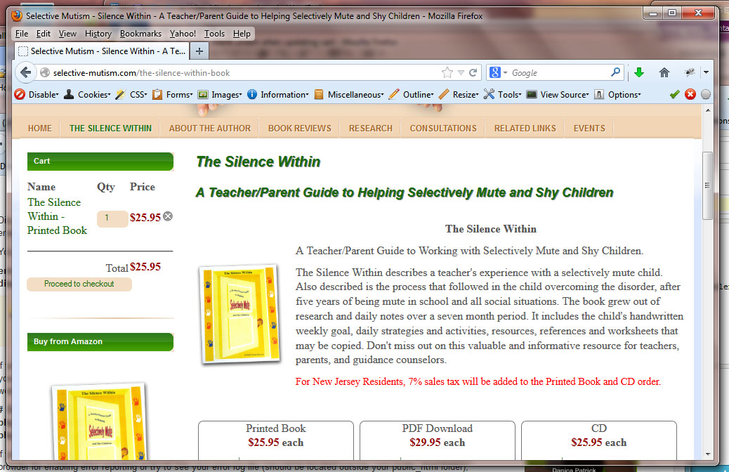

I just upgraded to latest version of hikashop and I'm still getting the blank screen in the old computer/OS. I can't recreate this problem on my new computer/OS (again that one I get intermittent blank screen). So far I can't recreate the problem on Apple's safari.
Here is the website: selective-mutism.com/the-silence-within-book

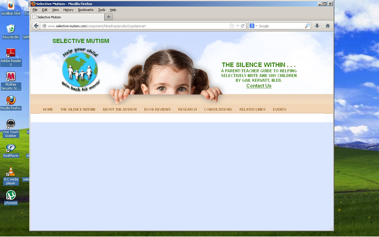

Attached is the blank screen shot.
When I get the blank screen, website is directed to url selective-mutism.com/component/hikashop/product/updatecart instead of selective-mutism.com/the-silence-within-book maybe an indication of the error?

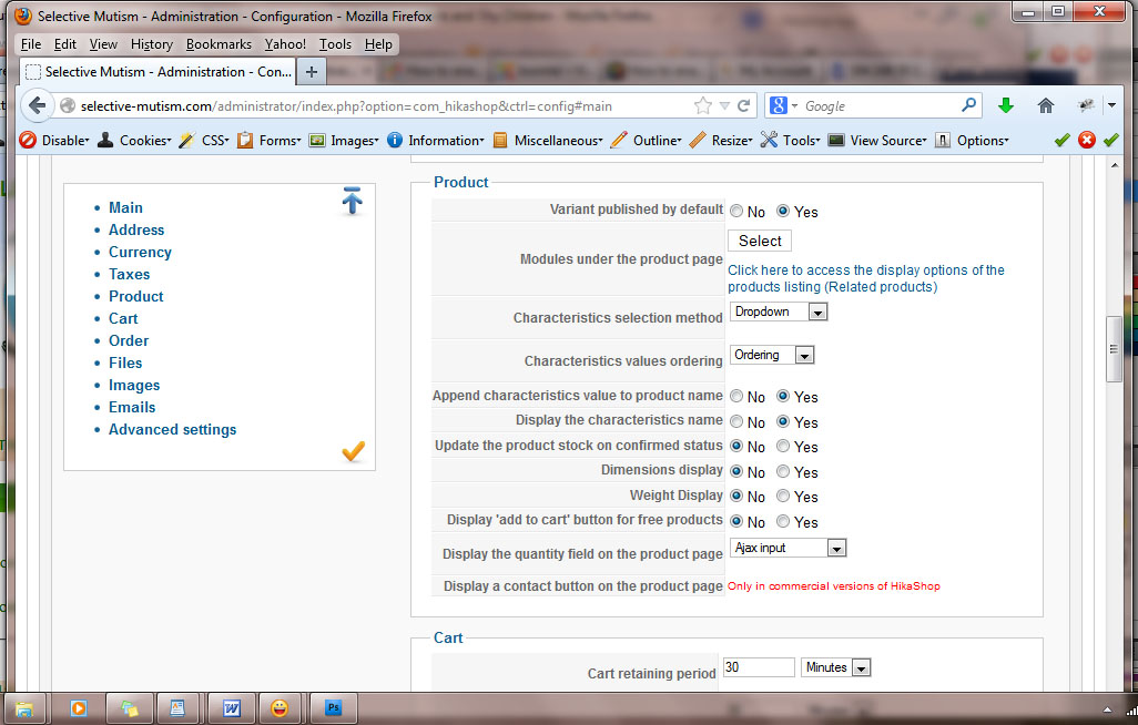

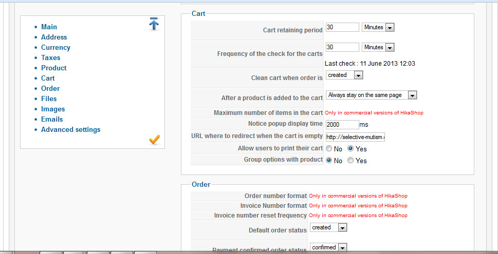

Can you try to toggle the option "Use AJAX when possible for add to cart buttons" and/or the option "After a product is added to the cart" of the configuration and try again.
I think that it should help avoid the issue.

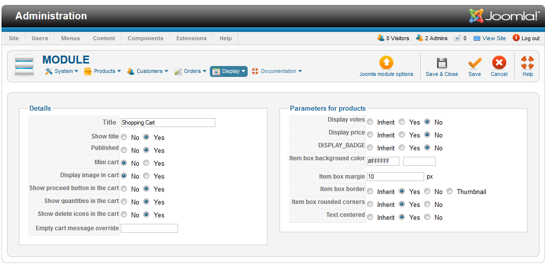

I think I am setting ajax (see attached of config screen).

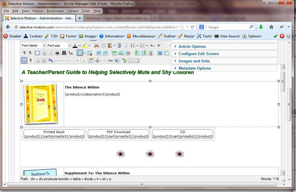

I'm also using Hikashop product tag insertion plugin (attached screen short of article containing insert tag). Is there a way to force ajax for this? Where should I set this if I'm using insert plugin.
I also attached cart cache setting (I've been playing around to see if which combination fix the problem, but so far nothing is working)

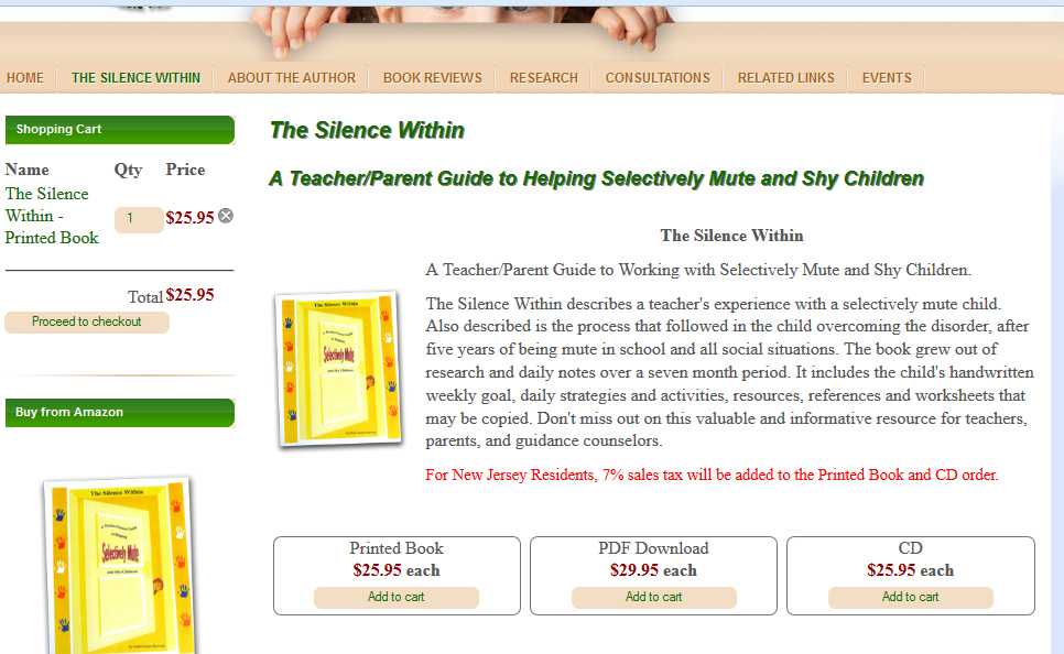

I attached screen when cart is working (the url shows selective-mutism/the-silence-within-book)
I attached screen whtn cart is not working and showing blank screen (the url shows selective-mutism/component/hikashop/product/updatecart)

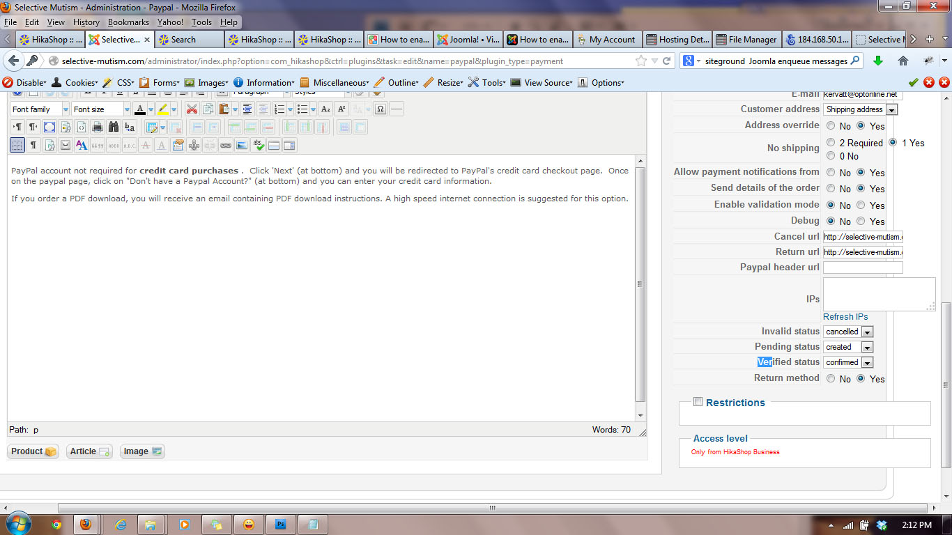

Can my paypal setting be causing the problem too (see attached)? I have Verified status set to confirmed (that's one of thing I changed not longer ago). I needed to change the order status after paypal, so someone who ordered downloadable file gets an automatic email.

You apparently have several cart modules configured with different settings. Can you please make sure that you only have one and delete the other cart modules via the joomla modules manager ?
The "After a product is added to the cart" option is available in the cart section of the configuration.

I played with the setting in Configuration-->Cart "After a product is added to the cart" but so far I get blank screen when I add/delete item on left column Shopping Cart. I want buyer to stay on the same page until they press proceed to checkout. What setting should I set for this?

If you go to left column (Shopping Cart) and try changing quantity or deleting an item, you will get blank screen.
