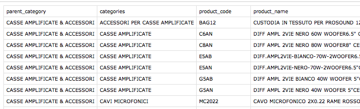

  • Posts: 46
11 years 10 months ago #108721
I have used parent_category to import from a CSV my database!
Please look attached images:
Now I need to export the same structure, what I need to do?
thanks

  • Posts: 46
11 years 10 months ago #108737
I think that I'm doing some errors, because if I import the CSV exported from Hikashop, I lose the main category!
Exactly "CASSE AMPLIFICATE & ACCESSORI"
I can't find the words "CASSE AMPLIFICATE & ACCESSORI" in the CSV exported!
Initially I've create the main categories using "parent_category"!
  • Posts: 46
11 years 10 months ago #108740
To see the problem, follow please this steps:
Import fromt text data this code:
parent_category,categories,product_code,product_name,price_value,price_currency_id,images
CASSE AMPLIFICATE & ACCESSORI,ACCESSORI PER CASSE AMPLIFICATE,BAG12,CUSTODIA IN TESSUTO PER PROSOUND 12,"19,97",EUR,BAG12.jpg
CASSE AMPLIFICATE & ACCESSORI,CASSE AMPLIFICATE,C6AN,"DIFF AMPL 2VIE NERO 60W WOOFER6.5"" CE ROHS","160,5",EUR,C6AN.jpg
CASSE AMPLIFICATE & ACCESSORI,CASSE AMPLIFICATE,C8AN,"DIFF AMPL 2VIE NERO 80W WOOFER8"" CE ROHS","213,5",EUR,C8AN.jpg
CASSE AMPLIFICATE & ACCESSORI,CASSE AMPLIFICATE,E5AB,"DIFF.AMPL2VIE-BIANCO-70W-2WOOFER6.5""CE ROHS","217,57",EUR,E5AB.jpg
As you can see you now have this structure:
Main Category:
Sub Category:
Now if you try to export, in the CSV downloaded file, you lose the main category!!
In the CSV the are not "CASSE AMPLIFICATE & ACCESSORI" !!
(I have just tried on your demo site!)
