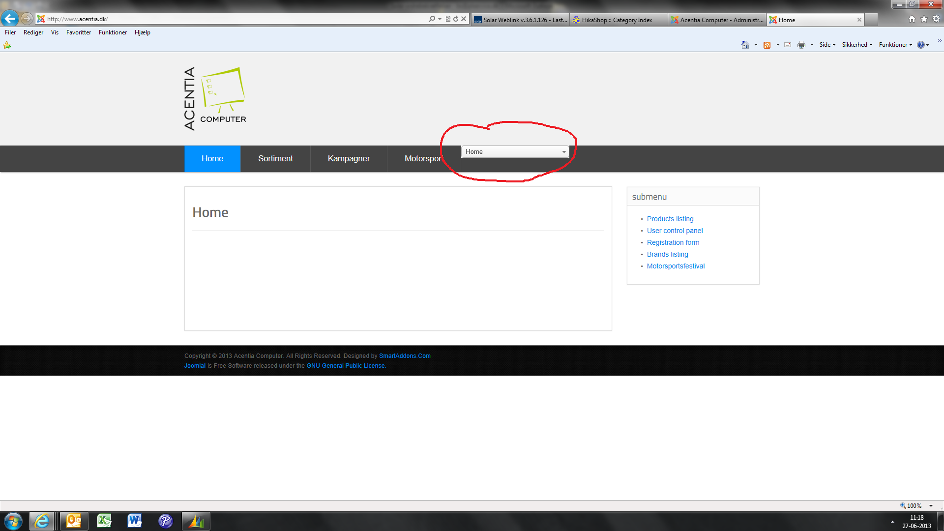

Hello
I having some trouble with the main menu, when I put Hikashop online and using the SJ Plus template.
It looks like that the "mobile main menu" suddenly appears next to the the real main menu.
Sorry if I'm not understandable...
But check out the attached image where I have marked the "mobile main menu" with a red circle.
I hope it makes it more understandable...

I think that this is a CSS issue, however I'll need a link to the page where you're having this problem for testing purpose.

Ok, you'll probably be able to hide it with some CSS code like :
Code:
#yt_mobilemenu_chzn {
display: none;

I made problem with mobile menu disappear by disable the option "use chosen library" in display options

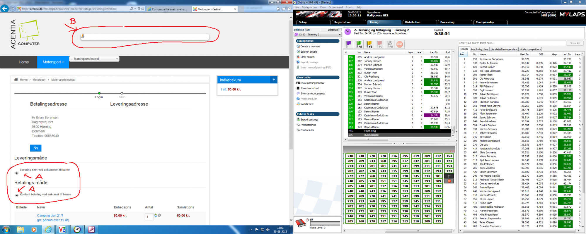

But I have a few more troubles in the checkout screen.
In attached screenprint see issue A and B.
Issue A:
I can't figure out how to align the radio button and text under delivery and payment options?
Issue B
Can I move the White line with the "edit" options to under the billing adress?
Or Make it look like the "New" button?
Issue A:
Issue B

There are no images in your message so I don't see what you're talking about.

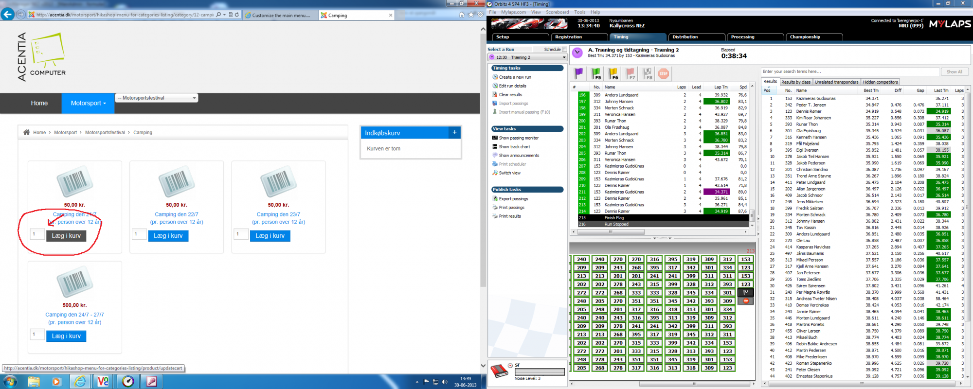

Sorry, my mystake.
Here it is.
I also would like to align the quantity field and add to cart button.
How can I do it?
Here it is.
How can I do it?

1. Regarding the quantity box, I think that some code like this will do the job :
2.
- For the payment line :
- For the shipping line :
3. And for your Edit button I think that the problem is coming from the code of your template bootstrap.css file :
Code:
.hikashop_product_stock td {
vertical-align: top !important;
2.
Code:
.hikashop_payment_methods_table td {
Code:
#hikashop_shipping_methods td {
Code:
.modal {
position: fixed;
top: 10%;
left: 50%;
z-index: 1050;
width: 560px;
margin-left: -280px;
background-color: #fff;
border: 1px solid #999;
border: 1px solid rgba(0,0,0,0.3);
*border: 1px solid #999;
-webkit-border-radius: 6px;
-moz-border-radius: 6px;
border-radius: 6px;
-webkit-box-shadow: 0 3px 7px rgba(0,0,0,0.3);
-moz-box-shadow: 0 3px 7px rgba(0,0,0,0.3);
-webkit-background-clip: padding-box;
-moz-background-clip: padding-box;
outline: none;
