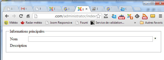

I am new to HikaShop. I have installed the most recent HikaShop Starter component on a Joomla 2.5.6 website. Everything seems OK except for a problem, quite an important problem :huh:
The "Add a product" link and the "new product" button are not working properly. All I get is an almost blank page containing only the following informations :
Main information
Name
Description.
That's it. Nothing but blank after the word "Description" and nothing else than these few words in the page (see the attachment).

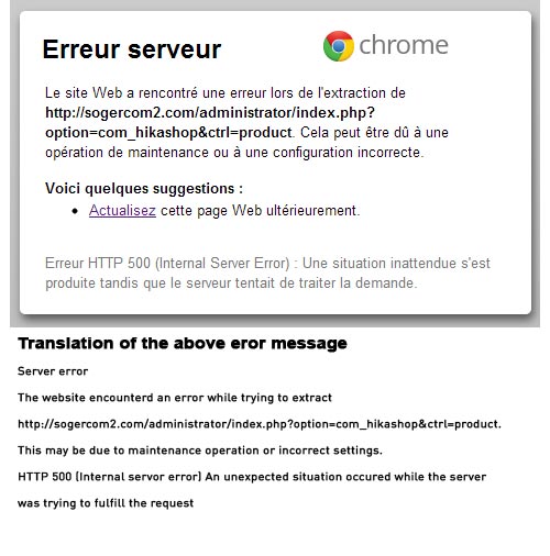

I have reinstall HikaSHop from scratch.
I have created a new database and imported the backup made before installing Hikashop (database, directorie and files)
I have downloaded a new copy of HikaShop, extracted it and install it from the TEMP directory.
To no avail.
I still can't use the "add product" link and the "New" Button for product.
Here attached you will find a print screen of the error message.
I can also give you access to the Joomla backend (No worry for error, the website is an exact copy of the original website hosted elsewhere, at another address.)
11 years 9 months ago #112282
A 500 error is a standard error message which is displayed when something goes bad. We unfortunately can't deduce anything from that expect that it didn't work...
Could you look at your PHP errors log to see what was the real error message ? (you might want to ask your hosting company about that).
Thanks.
