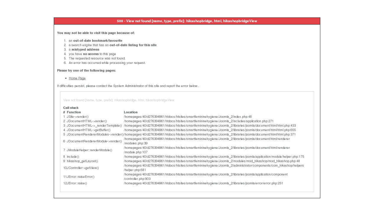

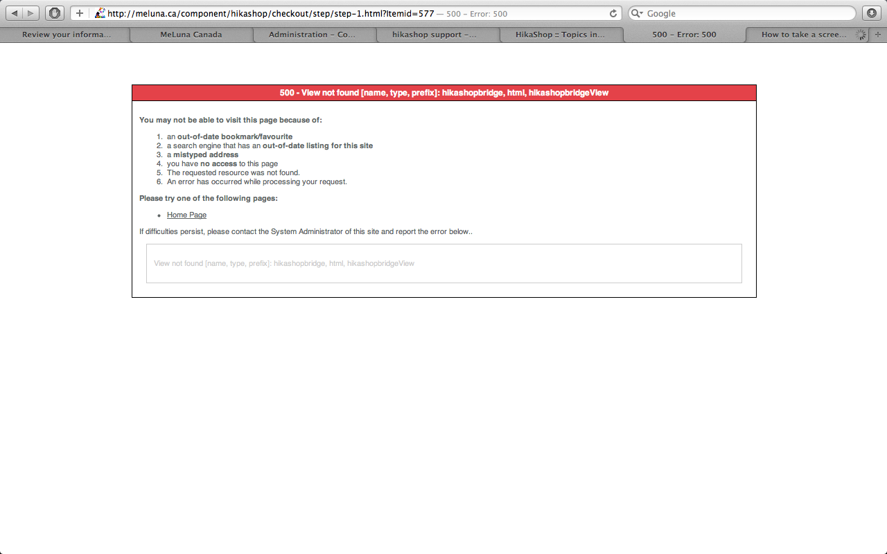

I just upgraded to business, and then installed alphauserpoints. Now, when I go to the cart and enter details and hit register, it takes me to this page. (I am posting a screen shot).
I tried disabling Alphauserpoints, but it didn't help. I would like Alphauserpoints to work, but I'm losing customers and would like to delete it if that is the problem.
www.meluna.ca

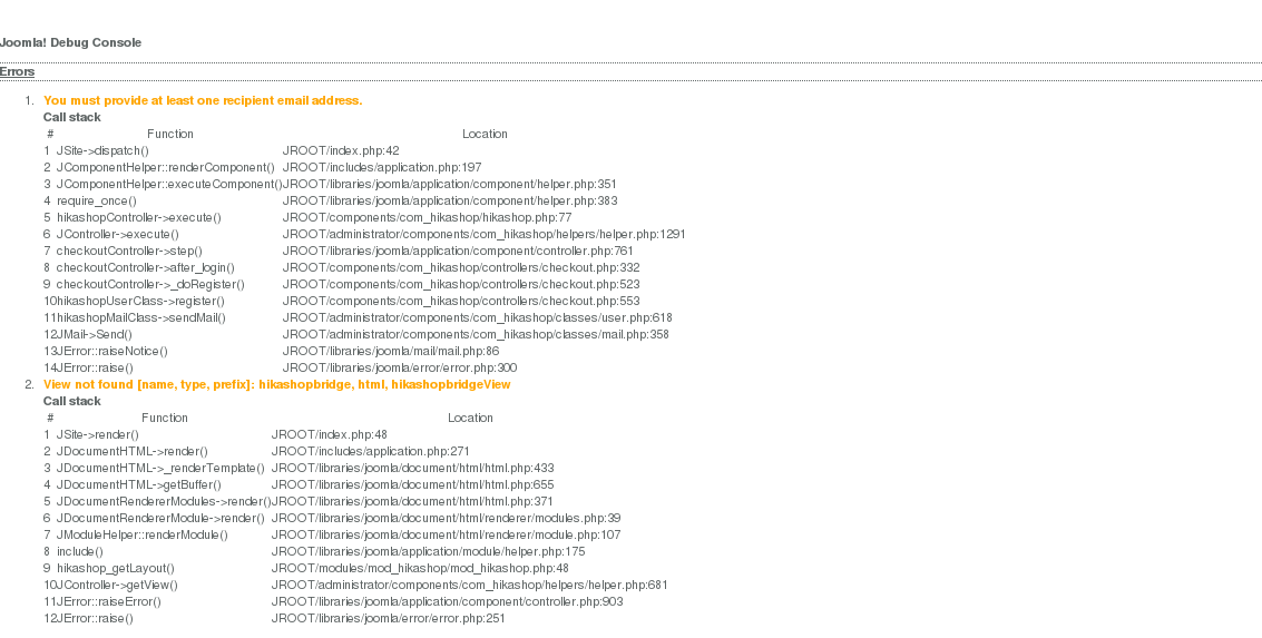

11 years 9 months ago #114557
Here is a screen shot in debug mode

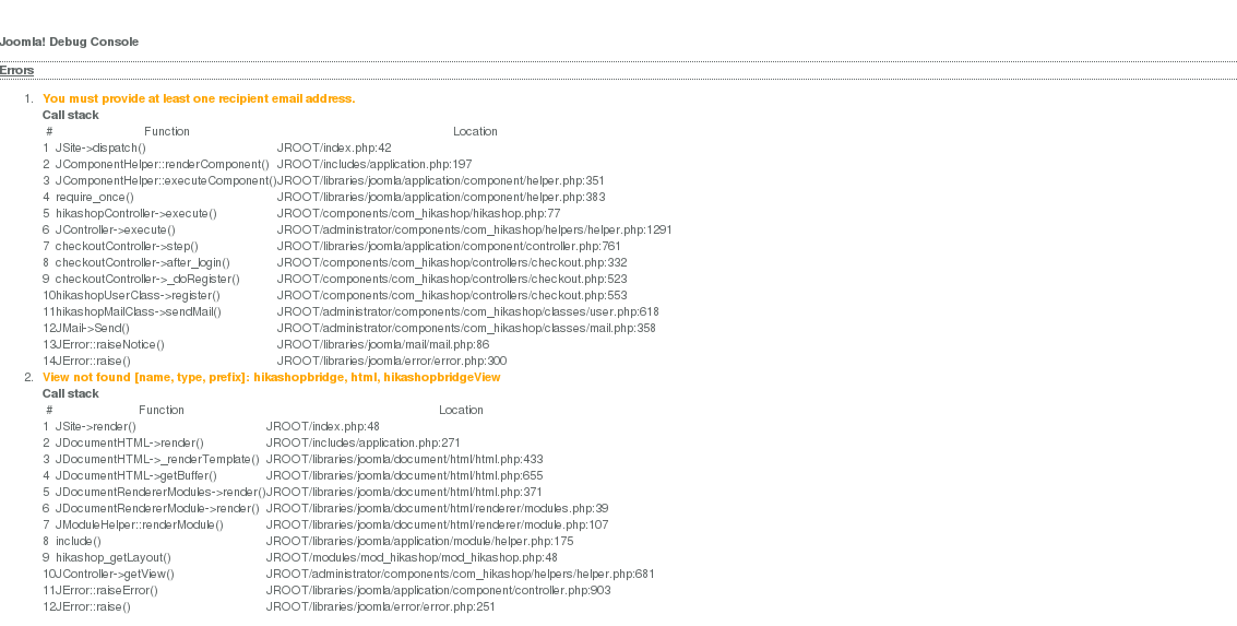

11 years 9 months ago #114558
Here is another one

11 years 9 months ago #114561
It's coming from a module of HikaShop.
Try to disable the module instances of "HikaShop content module" one by one via the joomla module manager to find out which one is the culprit and keep it disabled so that your website works again.
Then, you can try to go in its hikashop options and make sure that everything is correctly configured and save the options. Then, try to enable it again to see if that helped.
