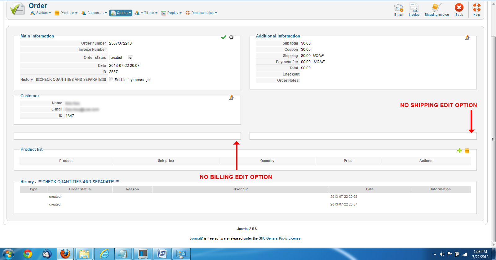

Hi guys, I just noticed that when I select the option to create a "New" order manually from the administration side, it does not let me enter in the users shipping or billing address. In this example, I tried doing this with an existing customer. I've attached a screen shot to show you what happens. Let me know if you have a solution for this. Thanks guys.

When you add the user, you need to turn on the "set user address" option and that will add the address of the user which should allow you to see the icons.
  • Posts: 66
11 years 6 months ago #115176
Hi Nicolas, I do select that option but it only loads the info under the "Customer" section. On the Shipping and Billing sections they are blank and the icons for editing those sections are missing. Checkout the screenshot.
Also, when customers create an order, the email confirmation that they receive is putting their billing addresses as the shipping address. We've had several customers call us. Although it's putting the billing address as the shipping address on their email confirmation, it's actually correct in the system. So, the order is fine in the system when viewed from the customer side or from that administration side, but something is going wrong with the email notification.

11 years 6 months ago #115280
We found out from where the problem was coming from and we fixed it, so you should just download the last version of Hikashop and install it again :).

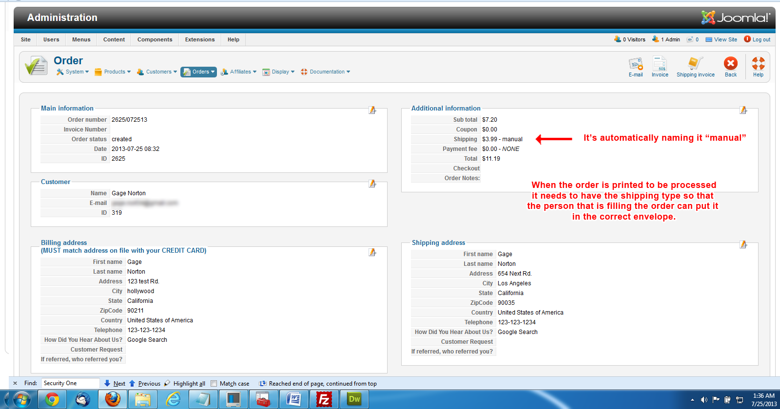

Hi Mohamed, I downloaded and installed the newest version under subscriptions and noticed 2 things that are happening. I've also attached a screenshot to show.
1. I created an order manually from the admin side and when selecting the shipping type, it automatically labels it "manual" instead of the actual shipping type that we've created (example: USPS Priority). The problem is that when we print the order for processing, it does not show the shipping type which is an issue for the order processor because they do not know what kind of envelope to put the order in.

11 years 6 months ago #115728
Regarding the first point we published a new build which fixes that.
You can download it on our website and install it on yours to get it to display like before.

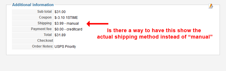

Hi Nicolas, I've attached a small screen shot of how the shipping method is being displayed. Is there a way to have this display the actual shipping method as it did in the previous Hikashop version? If you select the "edit" option you can see the shipping method, but it doesn't display on the order display screen. Thanks for your help :)

We made a patch in HikaShop in order to display the shipping name.
I guess that Nicolas publish a new build yesterday night (which include this patch), so you can re-download HikaShop 2.2.0.
