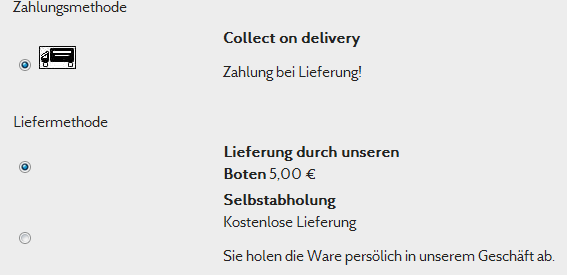

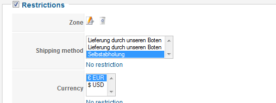

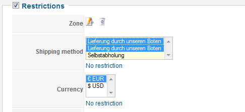

11 years 4 months ago #115487

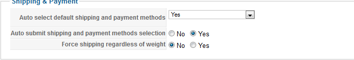

changing the delivery methode does not change the default payment methode
If I change to "pickup" (= Selbstabholung)
the delivery methode remains "Collect on delivery"
here the configuration
Collect on delivery
Pickup

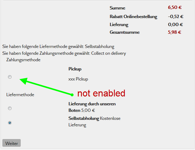

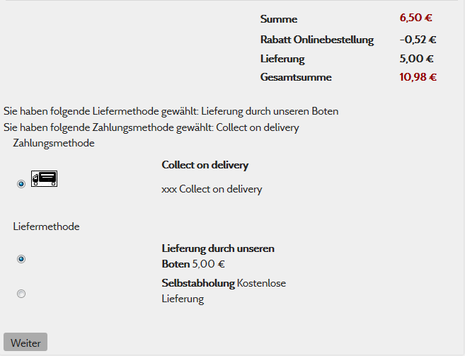

11 years 4 months ago #115547
no, it does not work for me.
If I change the deliver methode to pick up (=Selbstabholung), the [ ] pickup button should be selected (not only displayed on screen)
my plan is, to display no payment method. because there is only one per delivery option. so this should be selected automatically.

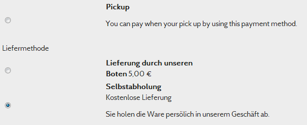

  • Posts: 29
11 years 3 months ago #115923
thank you for your great support!
I hope I'm not too annoying. :whistle:
The automatic switch now works.
