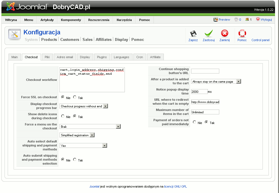

Could you do a screenshot of the tab checkout of the configuration of HikaShop ?

  • Posts: 3
  • Hikaserial Subscription Hikashop Business
14 years 2 months ago #9185
Thank you for your reply very much.
The joomla cache is off.
I forgot about one detail.
Normally it works great in IE8.
But try:
1. create account,
2. login to the new account with option "remember me"
3. try to buy something ==> the problem is appearing.
