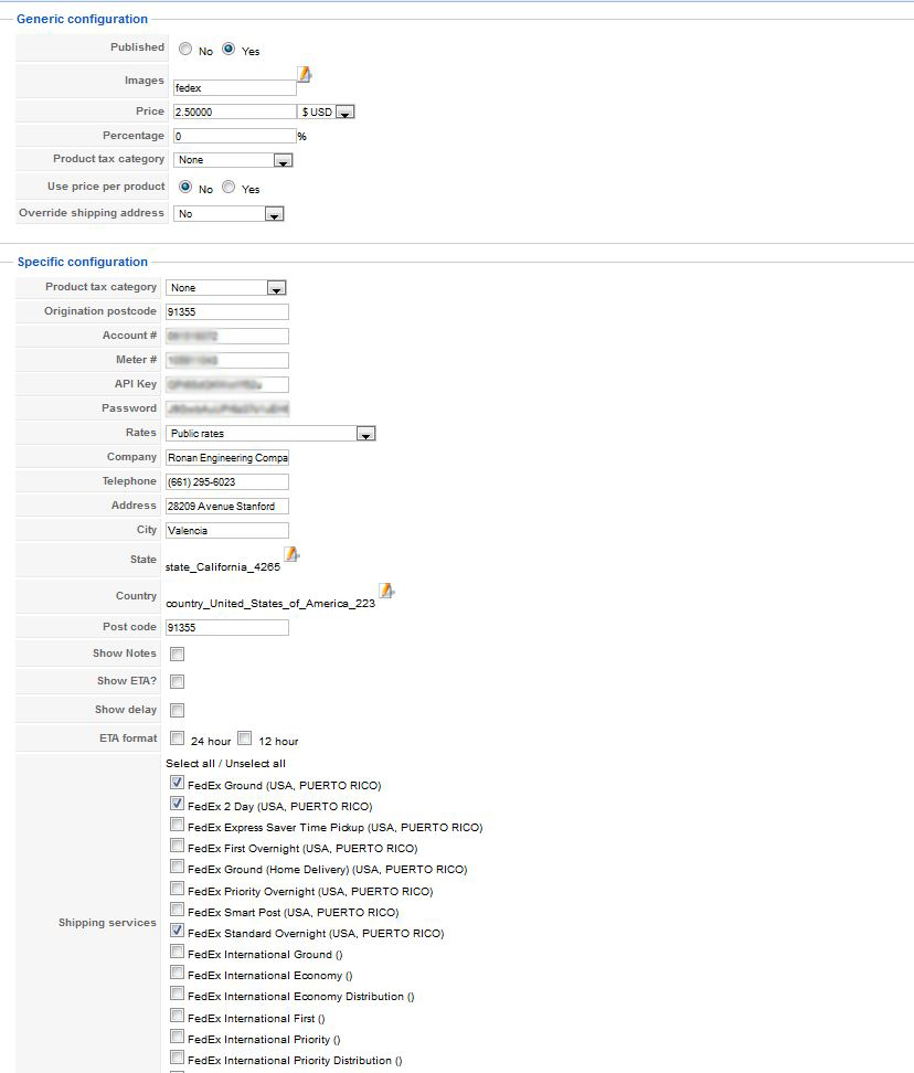

10 years 11 months ago #135809
Hello. I did check all the dimensions/weights of the products and they seem to be all set up (weight - in lbs and dimensions in inches). Still getting "No shipping method found." Here is a screen shot of our FedEx set up:
Appreciate any way you can help.
  • Posts: 82867
  • Thank you received: 13373
10 years 11 months ago #135815
I can see that you didn't select any international shipping method in your fedex shipping plugin options. Can you check that the address that you're using for your test customer is in the USA ? Otherwise, it won't work.
Besides that, it seems to be configured properly.
I tried to look at your checkout but I can't register and don't have a login so I can't test.
Regarding the error before logging in, it's normal that you get it the way your checkout workflow is configured. You should set the login view on a first step with the rest on a second step, once the user is logged in since your shipping gateways require the destination address to be known in order to calculate the shipping fees.

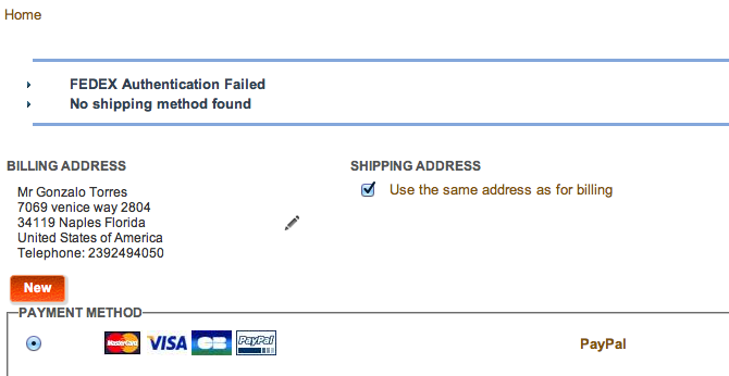

  • Posts: 5
10 years 11 months ago #136156

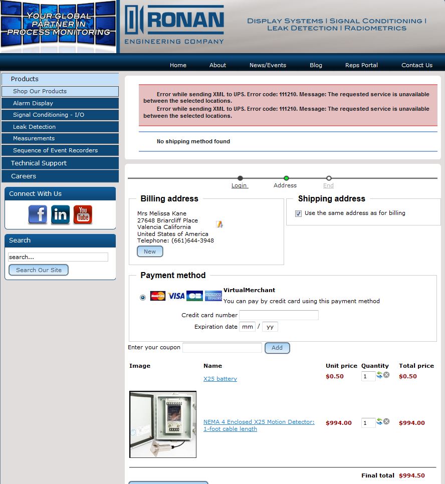

Okay, I followed your instructions to make login first and the other steps as a second step afterwards. Now you have the opportunity to register as a guest. But when I try checking out, I still get "Shipping method not found" in addition to another error in red. See attached image. ???
  • Posts: 82867
10 years 11 months ago #136160
That error means that Fedex didn't return the rates because none was available between your store address and the user address.
So there might be an issue with them, or the available shipping methods in your fedex account.
The Fedex support should be able to give you more information on the problem as it's something on their end now.

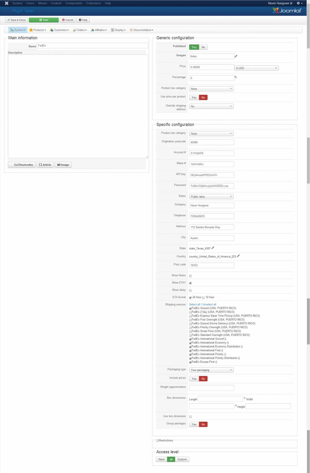

10 years 7 months ago #150797
1. Can you follow the shipping section of the FAQ ?
2. Can you show me how did you configured your shipping method and the product that you're adding to your cart through some screenshots ?
Thanks.

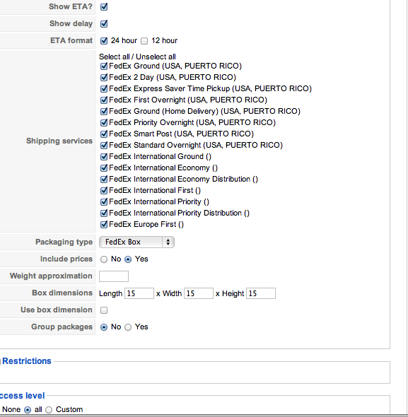

  • Posts: 2

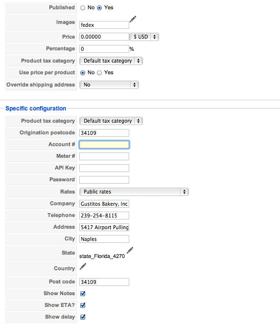

10 years 7 months ago #150876
Here is my information and this is what i get. PLease help me. I spent so much money on this and can't get it to work.
10 years 7 months ago #151216
Can you :
- Add your FedEx account information
- Set a value for the FedEx "Country" option
Through your FedEx shipping configuration page and try it again ?
Thanks.

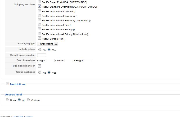

  • Posts: 15
10 years 4 months ago #162157
With mine, the FedEx is working just fine for the US shipments, but it shows the "No shipping method found" for the international shipments. All of my FexEx account info is in there, weight dimensions,etc. Does anyone know what is going on here and how I could fix it?
I've attached a screenshot of my setup
Last edit: 10 years 4 months ago by krossi. Reason: changed image
  • Posts: 82867

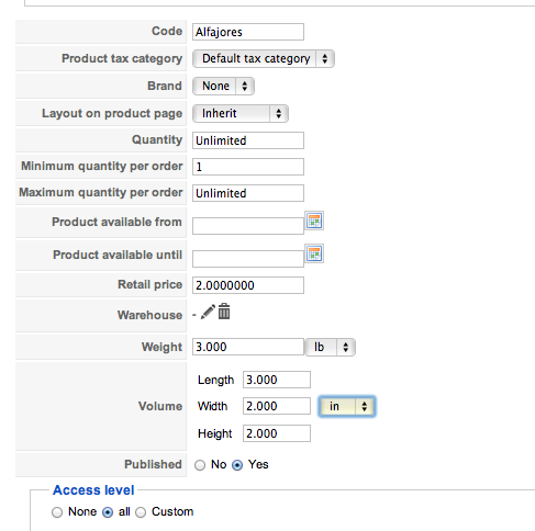

10 years 4 months ago #162261
Are you using the latest version of Hikashop ?
If not, I would suggest to update and see if that helps.
If yes, can you also provide a screenshot of your customer address, product dimensions&weight settings so that we can reproduce the problem on our end ?
