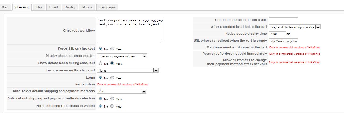

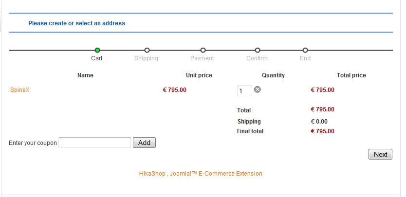

I've been trying very hard to get this to work but to no avail.. Can any help me with regard to getting an "address" table to come up during the order process. The site is www.easyfitness.ie

13 years 10 months ago #13741
As explained in the documentation, you can't have the address view without the login view before in your checkout workflow.

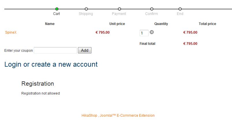

13 years 10 months ago #13751
I also tried that but I get the following with no table to fill in to create new account... See Pic

13 years 10 months ago #13753
That's because you deactivated the user account creation in joomla. You also turned off the login option in the config under the tab checkout.

  • Posts: 83338
  • Thank you received: 13477
13 years 10 months ago #13760
On Joomla 1.5, there is an option in the configuration of joomla.
On Joomla 1.6, it is located in the options of the user manager.

  • Posts: 83338
12 years 7 months ago #58876
You probably didn't remove the "address" view from the "checkout workflow" option of the configuration. Do that and it shouldn't bug you with the address.
