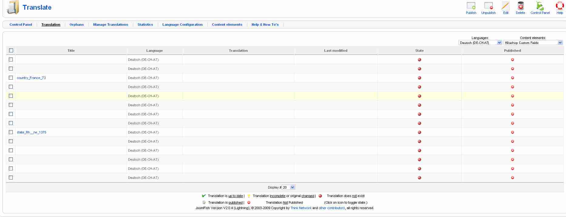

thx for nice soft, I just purchased.I attache obsolete in HikaShop package content element for method of payement - useful for multilangual site as mine is to translate the payment description
My question is why I can't see "Title" mostly in all hikashop content elements (back) - see an image attached. I hasn't such a problem with others components...
Any hint required ... :)

Hi Darek,
That's indeed a bug no one reported so far.
You can use the content elements in the archive below which should correct the problem:
File Attachment:
File Name: translations.zip
File Size:3 KB
We will include them in next release.

could you explain me what's the difference beetween older and newer *.xml files ? I use Notepad++ and see only [CR]difference... Is it anything else?

The type of the fields was changed from titletext to text for all but the main field.
