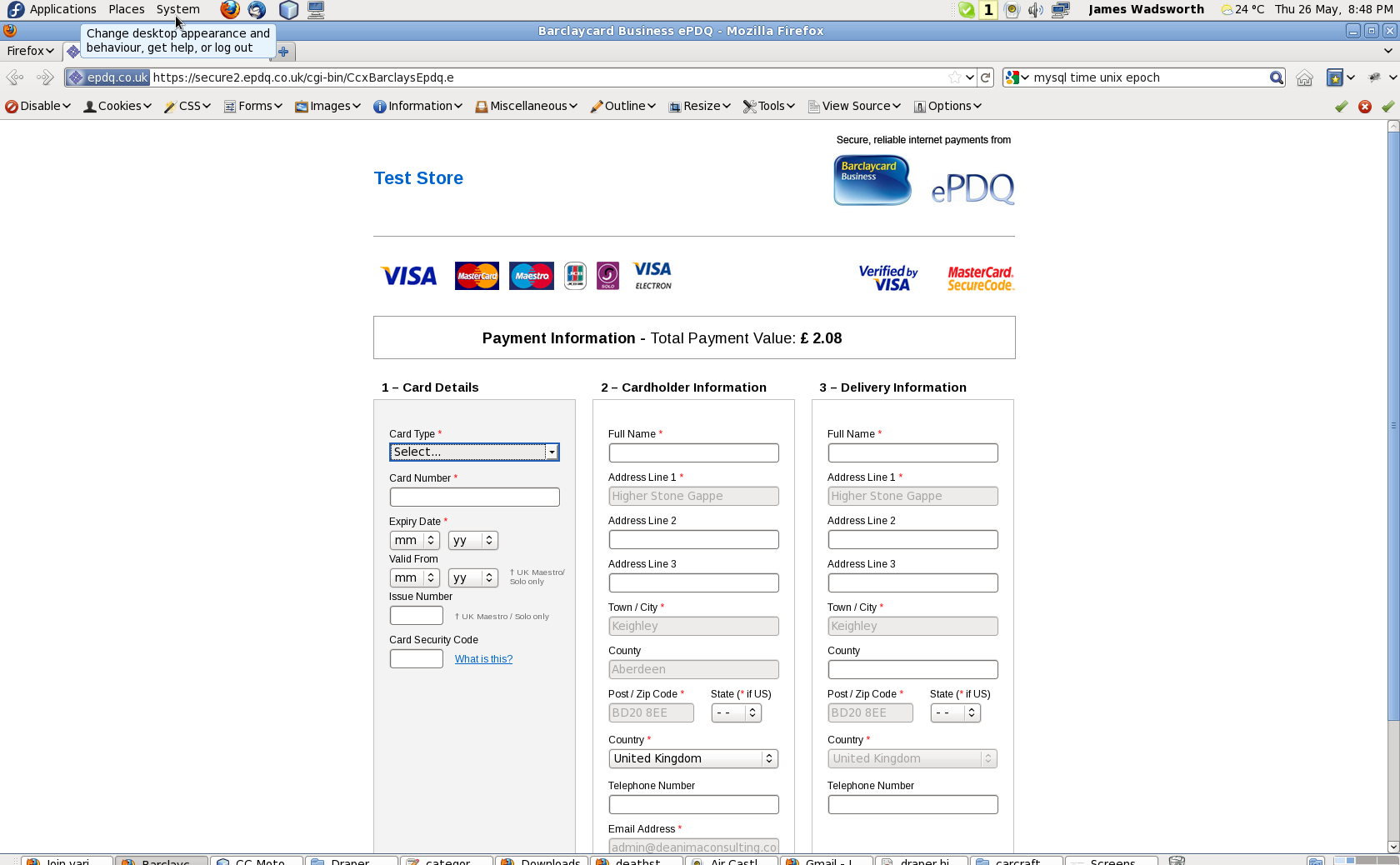

13 years 11 months ago #17263
Quirky to say the least. Any way forwards we go. As you can see from the attached screen we can connect and transfer all data to EPDQ server. The user fills in their card details and proceeds with the transaction. While the transaction is taking place, in real time, the epdq server communicates with the ecommerce site through the call back script. The call back script updates the status of the order. It is done this way in so that if the customer does not click back to the site the correct status has been assiged to the order depending on the outcome of the transaction. In the call back script what is the best way to update the status of the order? Thanks
