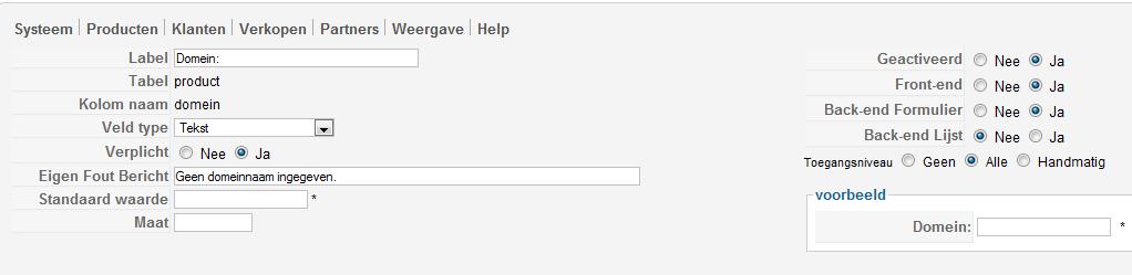

i'll post some ss's. Currently i have as followed (note GUI is in dutch)s
visible radio button on backend (mandatory to select if custom text field is needed)
custom field configured to have mandatory text input. However when radio is set to yes, field doesnt appear
item view has been modified with your code change
if(!$this->params->get('catalogue') && ($this->config->get('display_add_to_cart_for_free_products') || !empty($this->element->prices))){
       if(!empty($this->itemFields) && $this->element->custom_field_column_name=='yes'){

13 years 10 months ago #18528
Your custom product field's column name is "domein". So you should replace custom_field_column_name by domein in the code modification.

13 years 10 months ago #18530
still doesnt work, tried also tried domeinnaam & domein: none of em show the text box. If click to have the "product" field 'domein' to show up on the front end then all it sais is "Ja" (dutch for yes). But thats not what i want, i want the text box

13 years 10 months ago #18535
The problem is that you didn't replace the custom_field_column_name by the name of your custom field and you used the value Ja instead of yes in the custom field.
The code needs to correspond to the valeus in the custom field... So it should be:
if(!empty($this->itemFields) && $this->element->domein=='Ja'){
I've modified it on your view and it's working.
