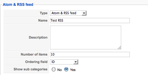

I am wanting to enable the RSS feed for only products that are in a certain category. Is this possible?
I've set the settings as per the screenshot attached, however I'm not sure where to go from here. I've looked through the documentation with no luck.
Thanks again.

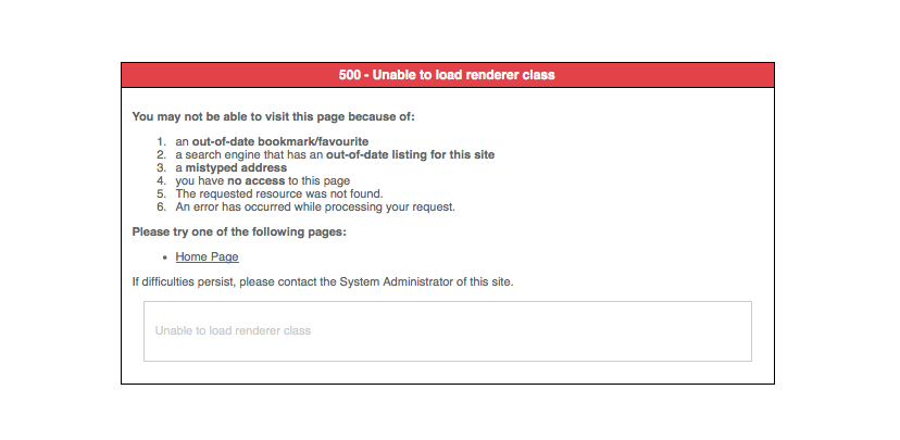

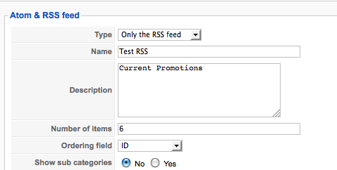

Thanks for this. I have subscribed to the feed for your demo site. But am unable to configure mine correctly.
I have attached screenshots of 1 - my configuration & 2 - the result when i try to subscribe to my own feed.

You didn't attach your second screenshot with the result when you try to subscribe.
The configuration is correct though.

13 years 9 months ago #20948
Here is the result I received when attempting to subscribe.

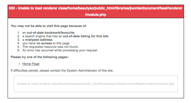

  • Posts: 136
13 years 9 months ago #20999
The URL is bellabuy.com.au/index.php?option=com_hik...ut=listing&Itemid=57
I have attached a new screenshot.
  • Posts: 83603
  • Thank you received: 13533
13 years 9 months ago #21003
Apparently, it's not possible to trigger the content plugins in order to process the content tags in the description of products when displaying the RSS.
Could you try to replace the code:
$desc = JHTML::_('content.prepare',preg_replace('#<hr *id="system-readmore" */>#i','',$desc));
by:
$desc = preg_replace('#<hr *id="system-readmore" */>#i','',$desc);
in the files components/com_hikashop/views/product/view.feed.php and components/com_hikashop/views/category/view.feed.php and then try again ?

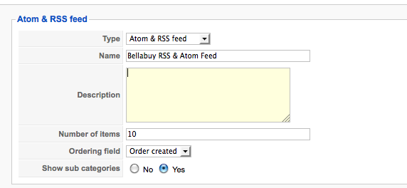

  • Posts: 136
13 years 9 months ago #21079
I had changed the configuration slightly to the attached screenshot.
Now when I click on subscribe to feed no product items come up.
  • Posts: 136
13 years 9 months ago #21080
Actually I've just switched to 'no feed' and then back to RSS feed and it's working.
