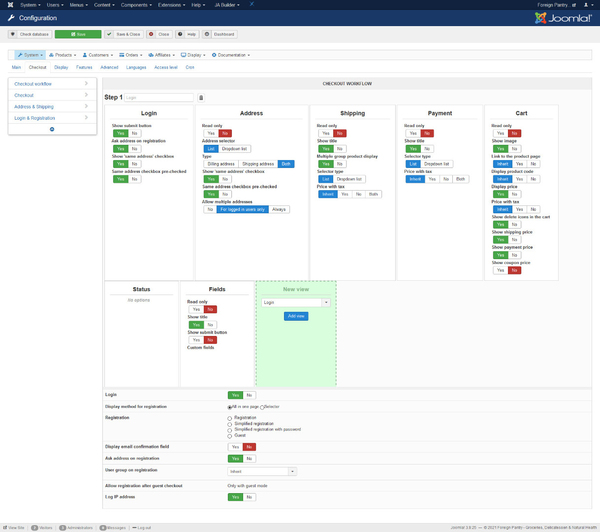

Sure. You just need to remove the view "coupon" from the "Checkout workflow" option of the Checkout tab of the config. More information about that option on:
www.hikashop.com/support/documentation/5...config.html#checkout

I would recommend you to first read this tutorial which explains how to modify your checkout workflow:
www.hikashop.com/support/documentation/4...eckout-workflow.html
Once you read it and understand how this all works, our messages here should be easier to understand.
More specifically, you just need to hover on the "coupon" view in your checkout workflow, and you'll see the delete icon to delete the view. Here is a screenshot:
i.imgur.com/jII0YtQ.png

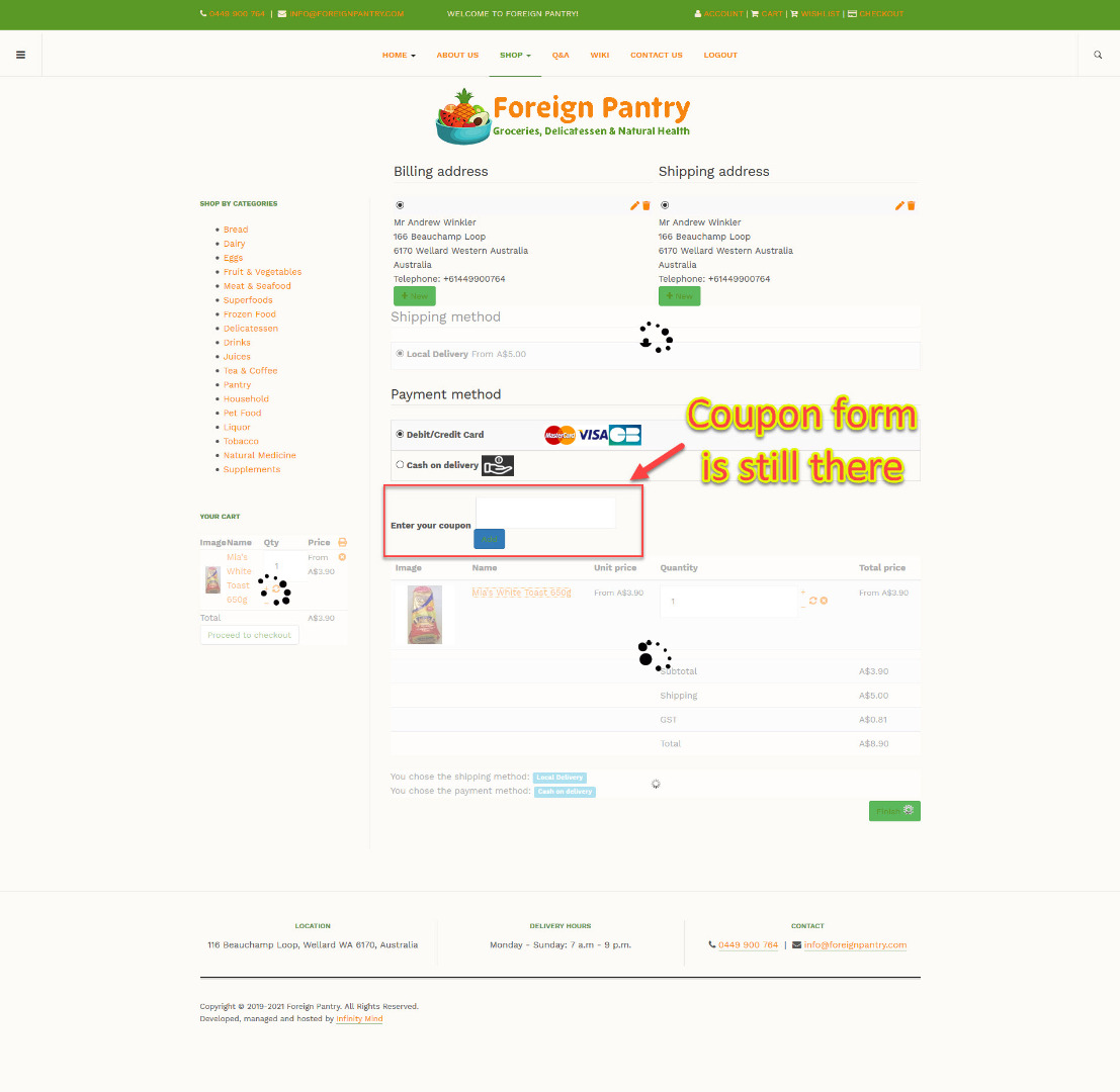

I've deleted the "coupon" column as you suggested.
However, the coupon entry form is still being displayed on the checkout page.
Last edit: 3 years 11 months ago by andrewwinkler.

Then you have to remove the block coupon in your Checkout Workflow settings.
You can reach these settings from Main HikaShop option => Checkout Tab, then Checkout Workflow part
Hope this will fit your needs.
