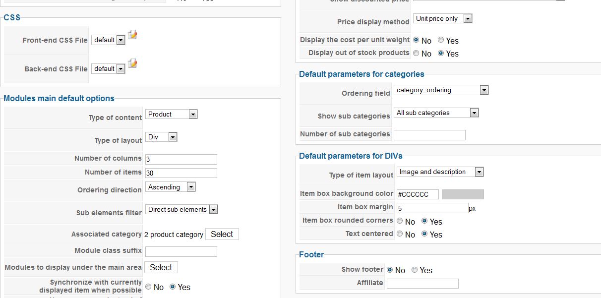

13 years 6 months ago #27372
I did how you suggested, the result did not happen.
I cleared the Joomla cache, nothing changed. i perhaps have a wrong config?
  • Posts: 83604
  • Thank you received: 13535
13 years 6 months ago #27381
That's not the hikashop options of your menu/module. That's the options of the Display tab of the config.
You can find the hikashop options of your menu/module via the menu Display->Content menu/module in HikaShop.

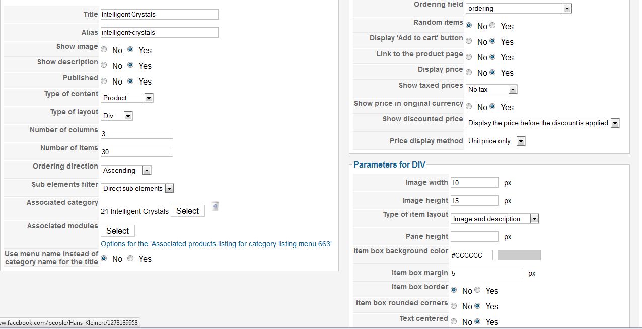

  • Posts: 24
  • Thank you received: 4
13 years 6 months ago #27393
I see, thanks.
Is this what needed to be done?
  • Posts: 24
13 years 6 months ago #27398
Thanks Nicolas,
Done,..... nice
