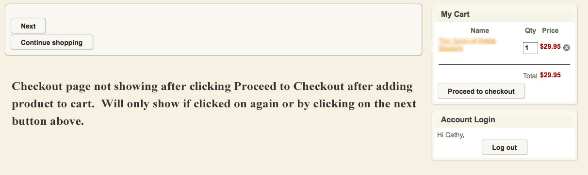

I need some assistance. It seems when I add an order to the cart and click on Proceed to Checkout cart module, instead of going to the checkout page it goes to a blank page and two buttons appear that say next and continue shopping. (please see attached photo) Now if I click Proceed to Checkout again then it goes to the checkout page where it asks for payment. Is there a way to fix this because I don't want people to get confused and give up and leave the purchasing process.

It seems that you set the option "After a product is added to the cart" of the Checkout tab of the configuration to "stay and display a popup notice" and that there is a javascript error or something like that on your website which creates that problem instead of displaying a popup notice.
Please check that option and make sure that you set it to "always go to the checkout".
If that doesn't solve your problem, please provide a link to your website so that we can have a look at the problem.
