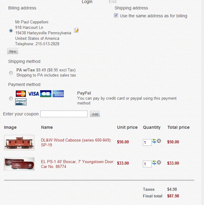

I am new the HikaShop and have been evaluating it as a replacement for Virtuemart. I have run into what I think is an odd issue with shipping being added to the order. For the past few weeks I have been building my HikaShop on a local machine and have been running Joomla 1.7.3 as localhost. Everything expect the Paypal IPN (that is a subject for another topic) is working fine when run on the my local machine under Xampp 1,7,4 (PHP 5.3.5). This is what the checkout page looks like when run under this environment.

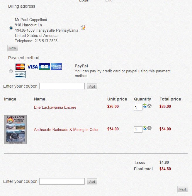

However, when I move the site from the local development environment to my Test/Dev Web server at my ISP shipping is not added to the checkout. Nothing has change in the HikaShop configuration as I used Akeeba Backup and Kickstart process to move it. The only thing that is different is the PHP, MySql, and Apache server versions. Here is the PHP info output for the local server I used. I will post an image of the Web server ISP behavior in a response to this post.

Here is the image of the checkout page from my Web server ISP based Test/Dev environment

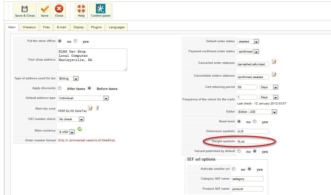

I don't think that is the problem either. I have the weight units set to lb, oz per below
