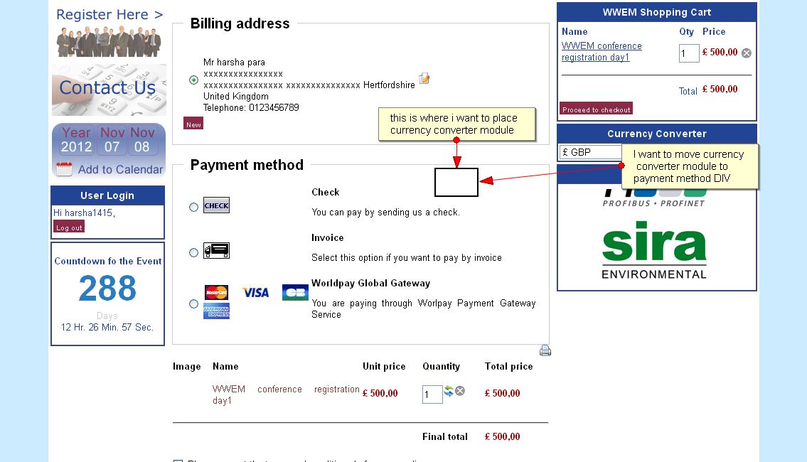

i want to load currency converter module into payment method selection (html div) in the checkout page,
currently i have the currency converter module in the right panel of the template.
is there any way to load module into joomla component menu item page
Thank you

i can use moduleanywhere if it is article something like that, but hikashop checkout page is not an article,it is component menu page i can't create that in article manager, i can only create through menu,here is the image so that u can understand my problem easily.
i want to change the currency converter module in the payment method options in check out page

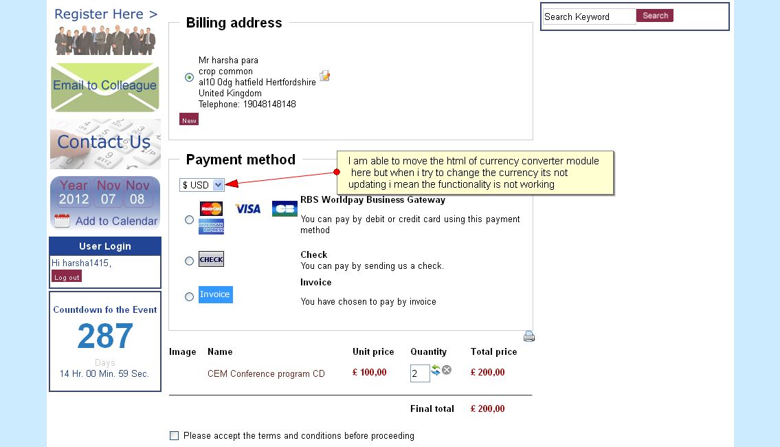

i tried to move the position of the currency converter module to checkout page which is the below one, i have added the below code in the payment.php file
jimport( 'joomla.application.module.helper' );
$module =& JModuleHelper::getModule('mod_hikashop_currency', 'Currency Converter');
$document = &JFactory::getDocument();
$renderer = $document->loadRenderer('module');
echo $renderer->render($module);
C:\xampp\htdocs\wwem\components\com_hikashop\views\checkout\tmpl\payment.php
after adding the above code i can able to see the html of the module but the functionality is not working
i have attached the image aswell
can please help me this out what i can do now
thank you

13 years 2 months ago #36494
Yes, that's what I told you would happen :)
It doesn't work because the form of the module conflicts with the form of the checkout.
To make it work, you will have to edit the file modules/mod_hikashop_currency/tmpl/default.php and change the code there so that it doesn't use an html form and instead does some javascript to do a redirect via a window.location.
