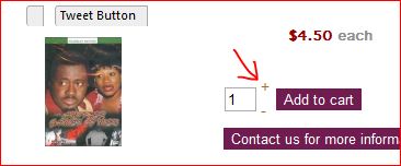

Thank you for the quick reply. I tried to follow your advice – but was unsuccessful. The link below has no variants for the products. If you click on the "plus" sign to increase the quantity to add to the cart, it won’t take it unless you type it. So I think the issue is other than the characteristics.
Also Adding to the cart usually displays "Item add to cart with options continue shopping or proceed to checkout!".
138salon.com/store138/product/118-anothe...ory_pathway-14.html#
I know you can help me fix this - please help
Note: It works fine sometimes...
