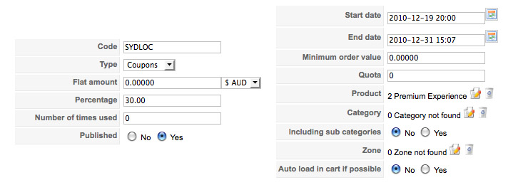

I have a little issue that I need to resolve. My client has a coupon that needs to be set for different products but is the same coupon code. After trying unsuccessfully to make a duplicate coupon with different product set to a certain value through the coupon area (passing an error: Error Saving), I tried to insert it through the database, but the database told me I can't have a duplicate entry with the same code. I know this really isn't what should be done, but I am now faced with an ad that states two different percentages for different products with the same code. Is there any way of changing the discount table to allow duplicate codes, and where would I adjust that in MySQL database?

  • Posts: 49
14 years 4 months ago #3697
Is the coupon quota ok ?
Set to 0 Default
Is the coupon end date in the future (or not set) ?
Future
Is the coupon start date in the past (or not set) ?
Future before end date. End date 8 days after
Is the coupon product in the cart (or no product restriction in the coupon) ?
Product restriction set in coupon
Is the coupon category a parent category of one of the products in the cart (or no category restriction in the coupon) ?
I have 6 products. I put all of them under category packages
In this new version I put one product in new category Diamond. All other packages where only one coupon was made for a product in that category.
Is the current zone (the state/country of the address of the user) in the coupon zone (or no zone restriction in the coupon) ?
No Zone restriction as it is all for anyone
The following images is how I set it initially. So I think I am gathering you can only have one coupon code no matter what. Making two with the same name, but different product or different categories with different percentages off won't work?
  • Posts: 83674
  • Thank you received: 13545
14 years 4 months ago #3700
It won't indeed. The only solution would be to have a different code.
