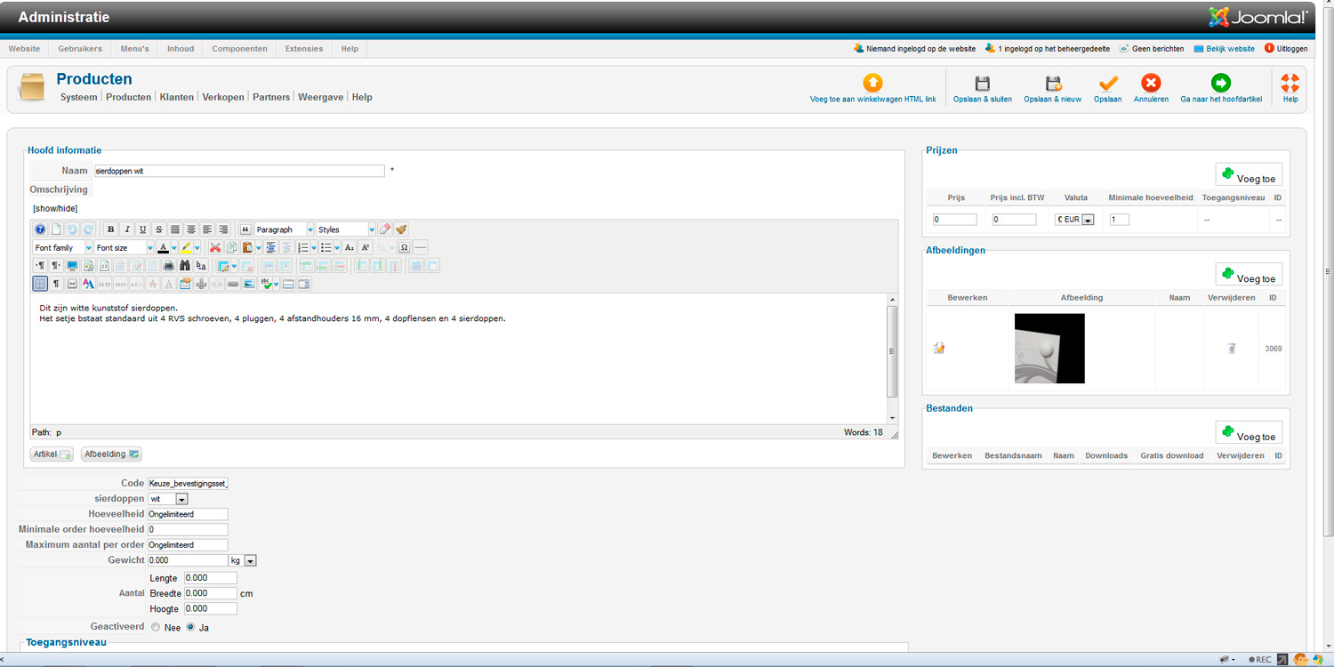

I added a product option (mounting option) to my product, but I don't know how to show the imgage of that option?

Options do not add images to the main product. If you want, you can specify a URL of a joomla article in the URL field of your option product and then the users will be able to click on the question mark icon to see the content of that page in a popup.
