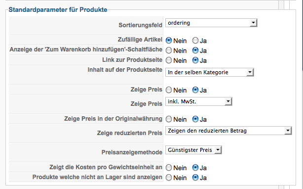

Please check your HikaShop menu configuration ("Display > Content menus").
There is an option in "Parameters for products" called "Link to the product page".
Otherwise, in the general HikaShop configuration, tab "Display" there is the same option in the fieldset "Default parameters for products".

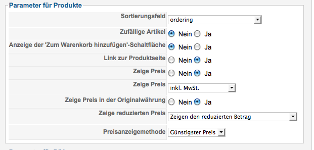

  • Posts: 75
12 years 11 months ago #39103
Jerome
I already have done these setting.
Do you have another ideas?

You should go in the menu Display->Content modules and edit the module with the id 117. There, you will find the same option that you can turn on to have your products clickable.

"117" was the ID for the module in Scheinbacher's website.
Nicolas gives this ID because it was easier for Scheinbacher to find his module.
You have to edit an HikaShop category module.
Your page " travellersridge.com/merchandise/category/12-horse " have a product which is not clickable.
Opening the source code ofo the page, you can found into : "hikashop_category_information_module_168".
It means that you have to edit the module "168" and configure the option.
