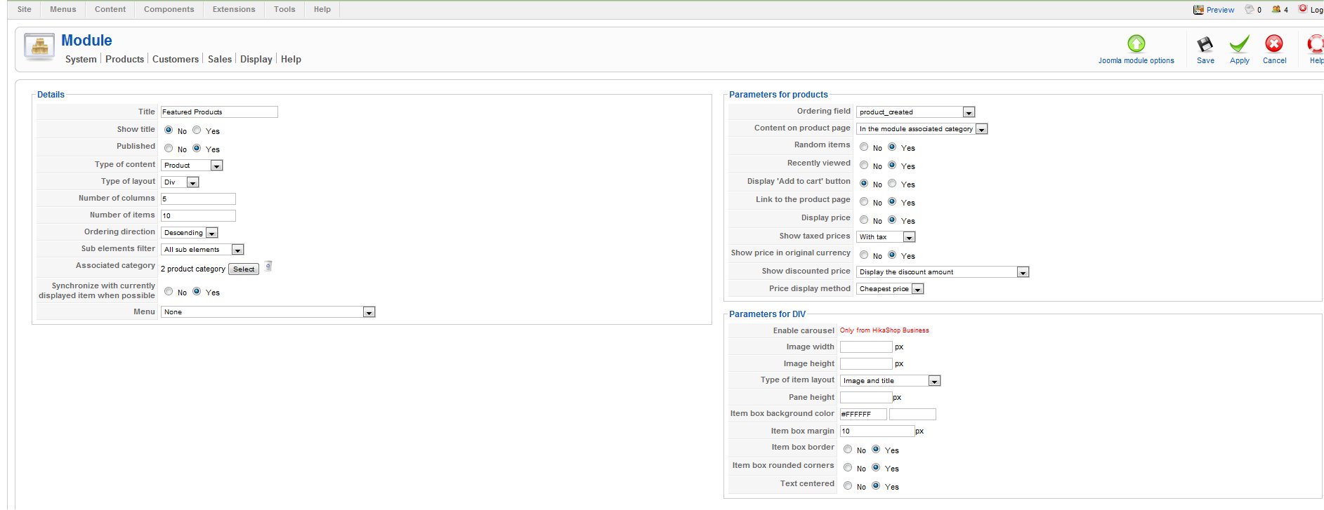

I have attached the modules parameters

As I said in my previous post, in that screen, you need to set the "menu" option to a HikaShop category listing menu.

This is a module in tabs not a menu mod_hikashop

Yes, this is a module options screen. But look right at the bottom. There is the "menu" option that I'm talking about.

Solved Cheers
