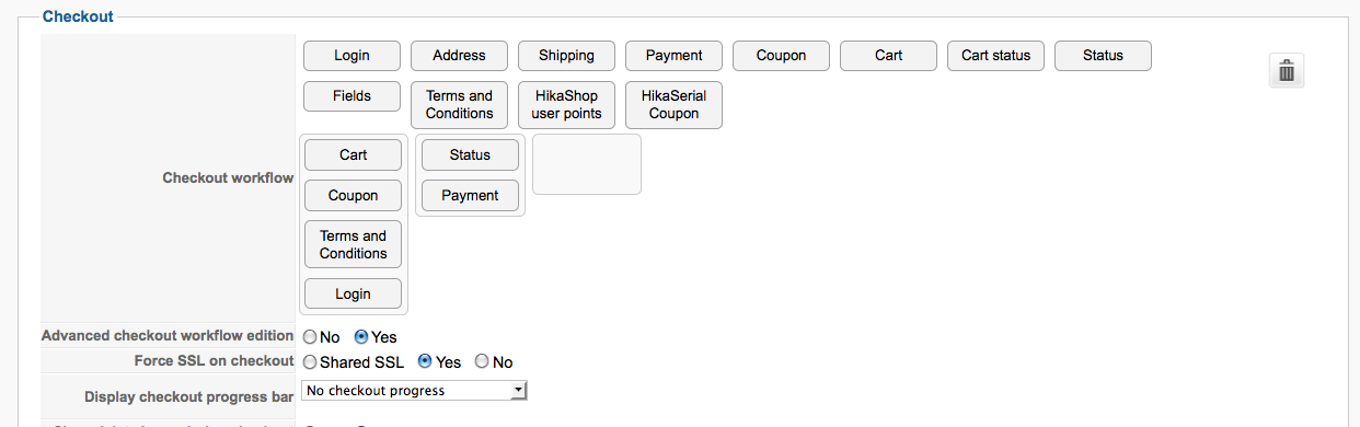

My Checkout Workflow is as follows:
cart_coupon_terms_login,status_payment_confirm,end

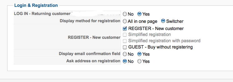

The Switcher is set to 'on' so users can switch between either Log in or Register.
When I Log In as a user, everything works fine
However when I Register I get the error message 'please enter a value of the field name'
It's strange because I didn't have this problem when I first set it up... but I must have changed something which means it is now not possible to Register.
Do you have other suggestions as to what might be the problem?
Last edit: 10 years 8 months ago by claratuckbones. Reason: Left out some information
10 years 8 months ago #165657

  • Posts: 10
10 years 8 months ago #165685
Here are some screenshots - I have sent a private message with the log in details of the website I'm working on.

Thank you for the access.
I was able to see the problem which is actually quite different from the problem of the other user on this thread even though the same error message is displaying.
On your end, the issue is that there is this CSS code:
tr#hikashop_registration_name_line{
display: none;
in the CSS file www.doofa.com/templates/doofa_4/css/default.css of your template which hides the name field of the registration form. But the name field is still there and the check for the value entered in that field is still there. Just hidding the field in CSS is not enough.
So either remove that CSS so that customers can fill in their name and it will work.
And if you don't want that field, instead of hidding it in CSS, you should rather change the option "registration" to "simplified registration with password" in the configuration of HikaShop. That will remove both the username and name fields of the registration form and it will still work.
