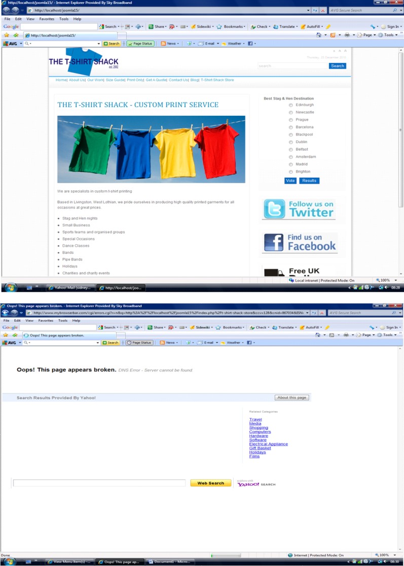

I have attached a word doc with a screenshot of the homepage. The menu item is T-Shirt Shack Store and the screenshot below it shows the result when clicked.
I currently have this menu item set up as Hikashop - Category Listing

  • Posts: 83674
  • Thank you received: 13545
14 years 4 months ago #4027
Could you copy/paste the link which is broken ?

Could you do a screenshot of the page once you opened it ?
  • Posts: 51
14 years 4 months ago #4263
This is the message received
500 - View not found [name, type, prefix]: menu,html,menuView
